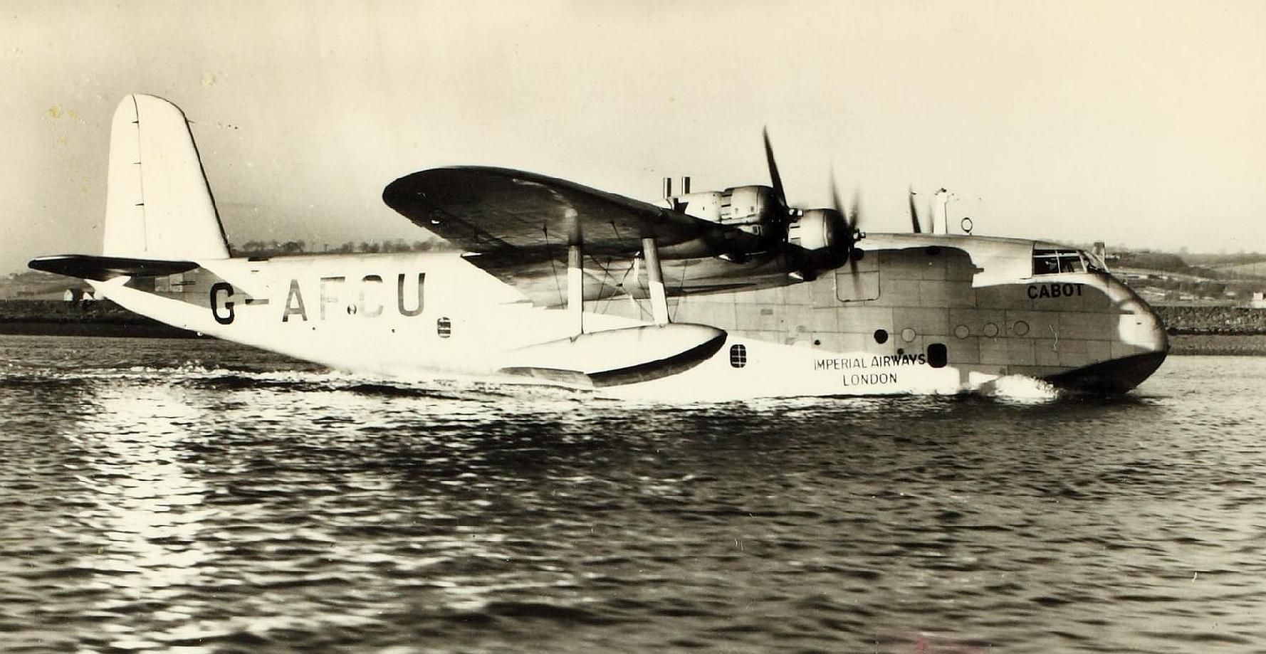

The first of the S.30 flying boats to be laid out and completed was G-AFCT, named 'Champion'. In December 1938, the second S.30 aircraft G-AFCU, named 'Cabot' became the first aircraft of the series to conduct the first successful takeoff. The last three aircraft of this order – 'Captain Cook', 'Clare' and 'Aotearoa' – were renamed and re-registered for use by TEAL. In 1939, a final S.30 flying boat, G-AFKZ, was ordered and delivered to Imperial Airways in late March 1940.
A total of four flying S.30 series flying boats – Cabot, Caribou, Clyde and Connemara – were equipped with in-flight refuelling equipment and extra fuel tanks in order that they could be used to provide a regular trans-atlantic airmail service. The concept was for the aircraft to take off at lower weights and, once airborne, take on extra fuel to reach an all up weight of 53,000 pounds (24,000 kg), giving the aircraft a range of over 2,500 miles (4,000 km). The extra fuel reduced the payload to 4,270 pounds (1,940 kg) against the 6,250 pounds (2,830 kg) of the standard aeroplane. The refuelling was performed by three converted Handley Page Harrow bombers, one operating out of Ireland and two out of Newfoundland.

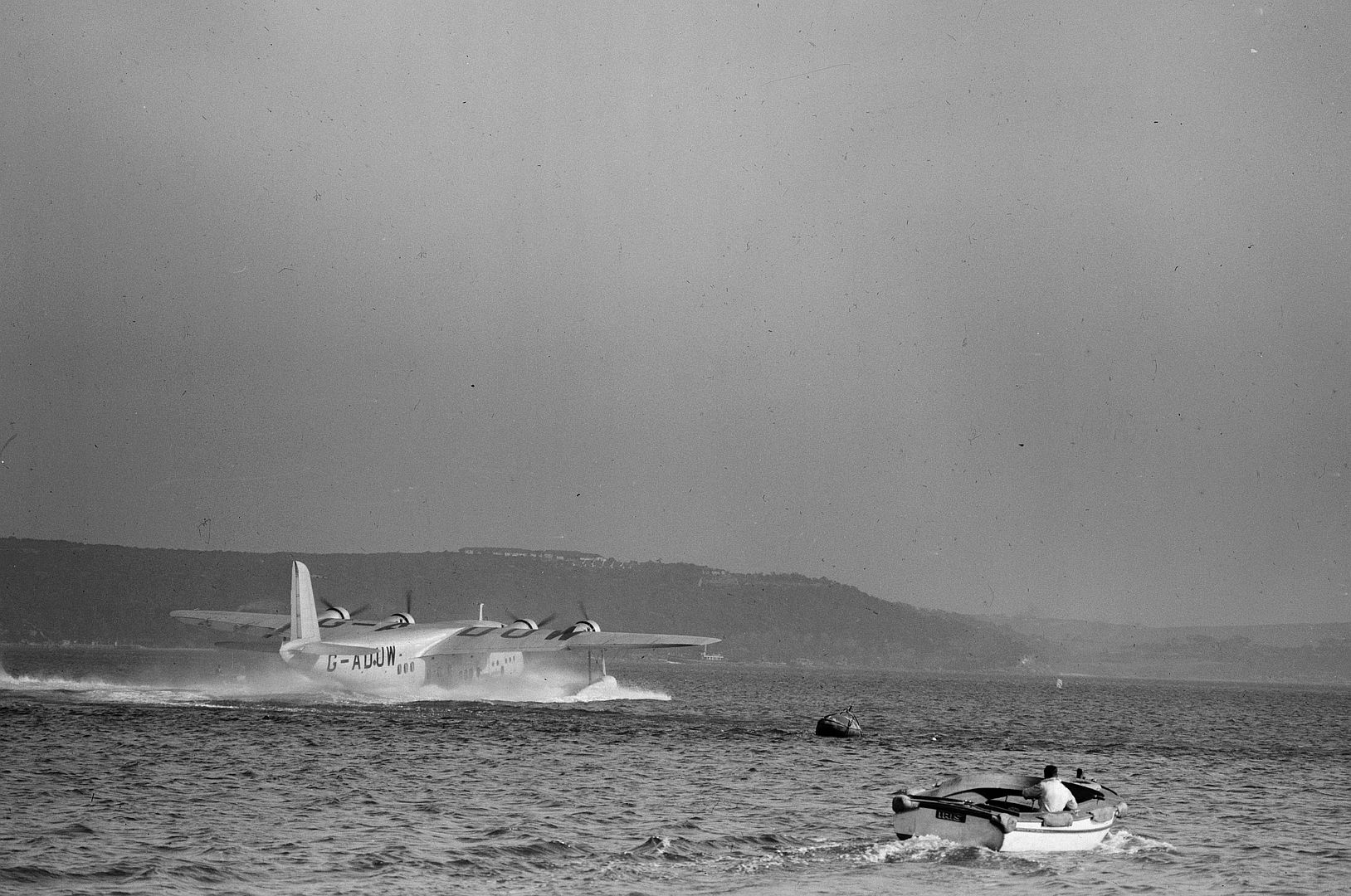

G-ADUW Castor Imperial Airways, later BOAC

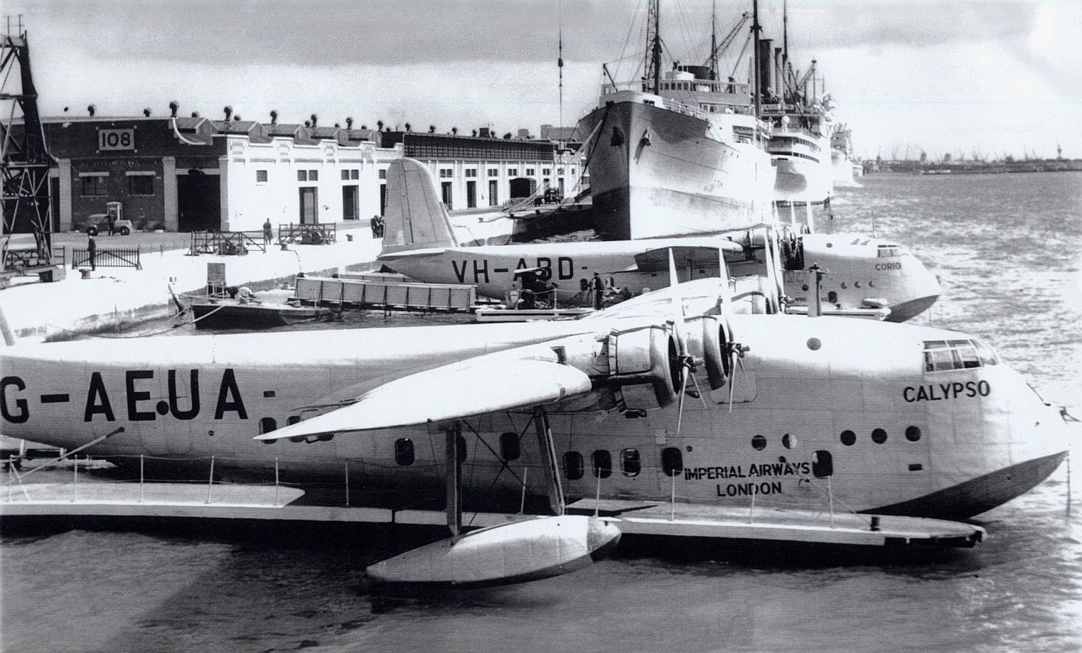

G-AEUA Calypso Imperial Airways, to QANTAS in 1939 not used directly, to RAAF (as serial A18-11)

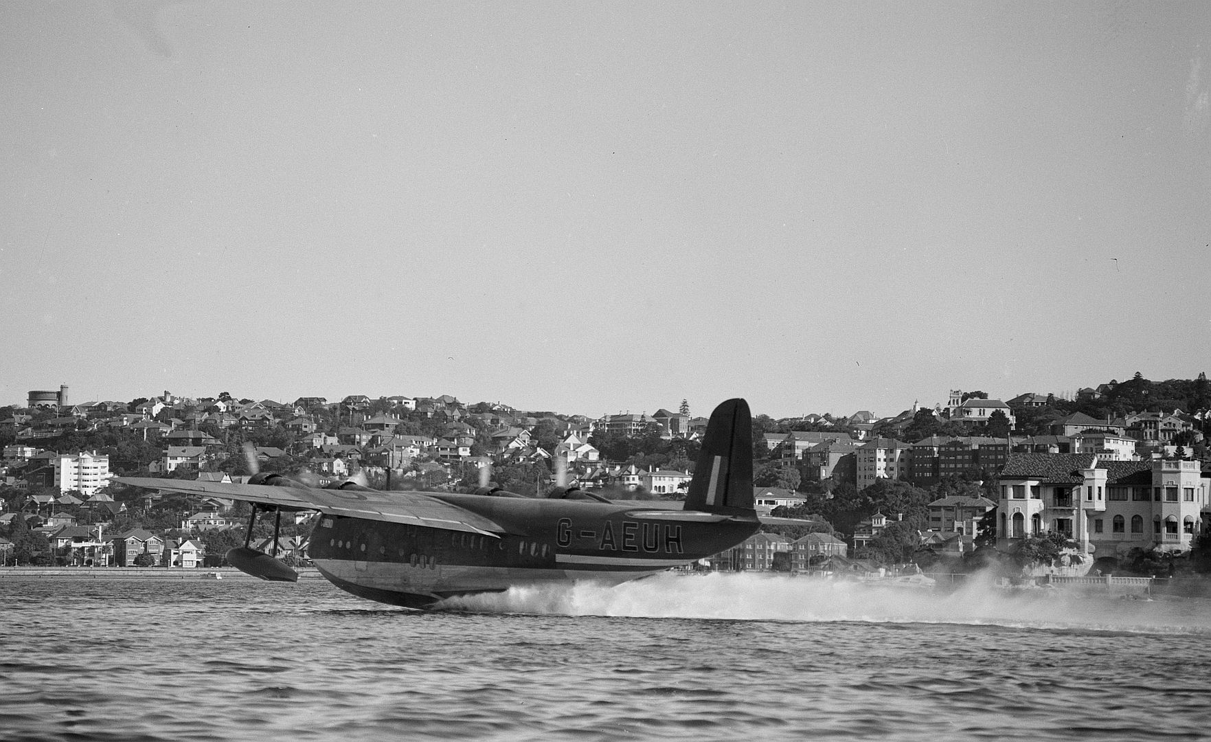

G-AEUH Corio Imperial Airways, to QANTAS in 1938 (as VH-ABD), to Imperial Airways in 1939 (as G-AEUH)

G-AFCU Cabot Imperial Airways, to RAF in 1939 (as V3137). Destroyed 5 May 1940

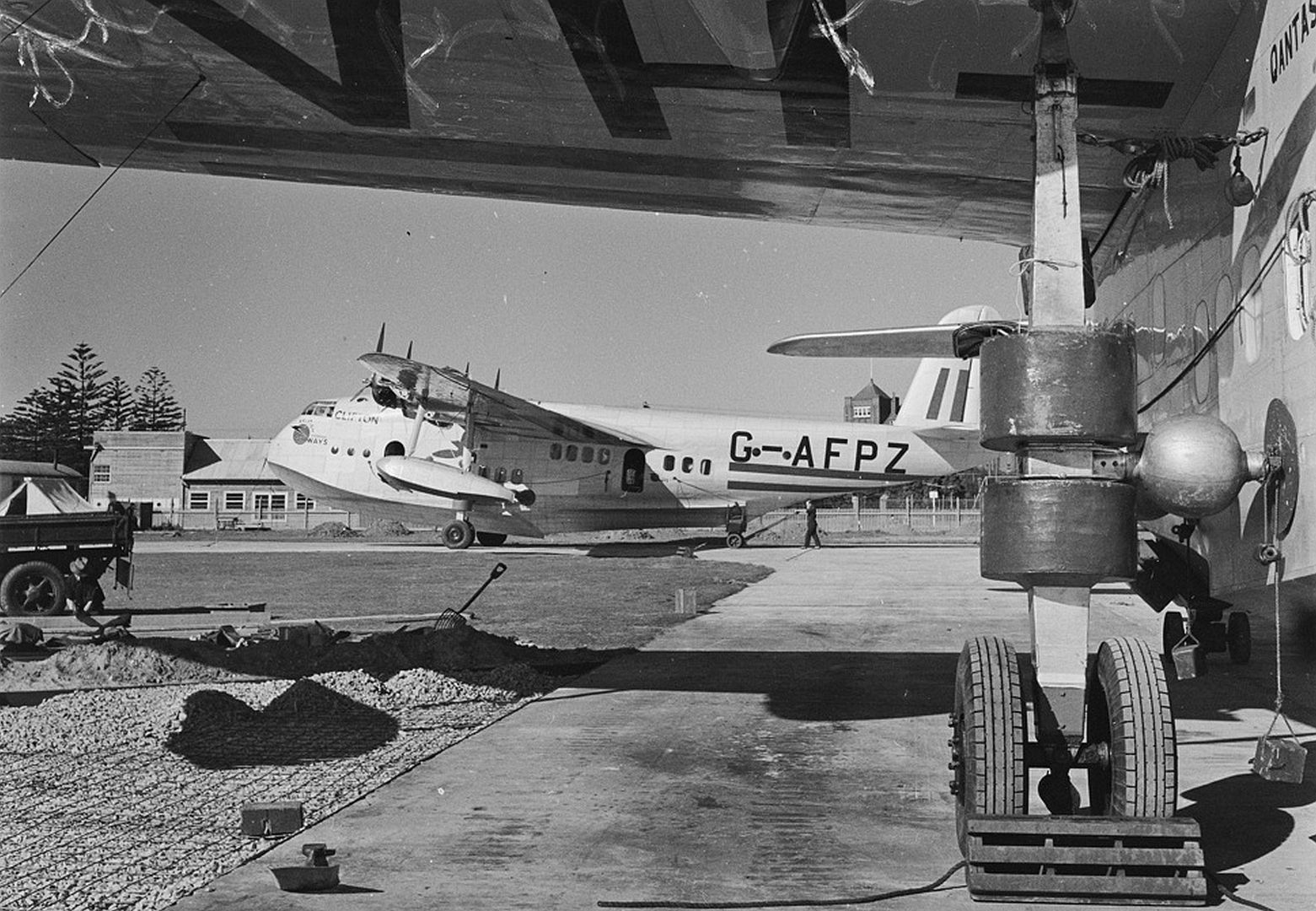

G-AFPZ Clifton BOAC, to RAAF (as A18-14), to QANTAS in 1942 (as VH-ACD)
