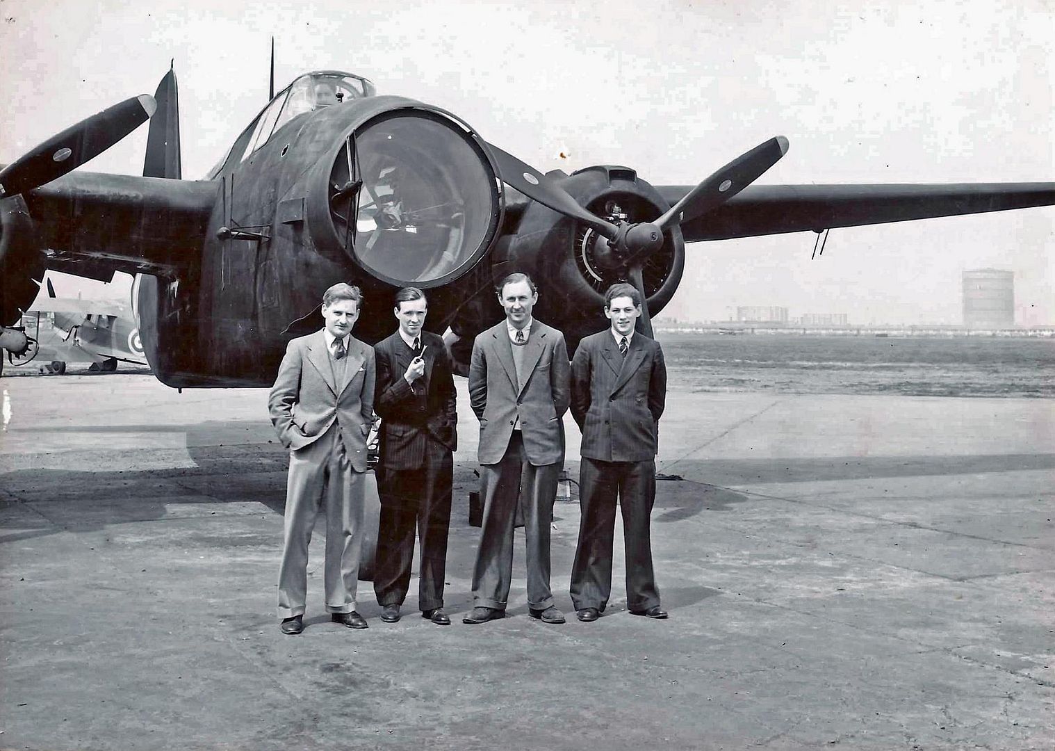

The searchlight was developed and built by GEC, and was fitted into the nose of the Havoc behind a flat transparent screen with power for the light coming from heavy lead-acid batteries fitted in the Havoc's bomb bay. Battery power for the 135 kW (1,200 Amp) searchlight was sufficient for about two minutes of operation. The Havoc's own armament was removed from the nose.
The radar fitted was the AI Mk.IV, with broad "arrow head" aerials protruding from the both sides of the aircraft nose with additional side-mounted, and upper- and lower-wing mounted, dipoles. The modifications were carried out at Burtonwood Aircraft Repair Depot and the resulting aircraft was known as the Havoc I Turbinlite.
The unarmed Havoc Turbinlite was intended to find the enemy bomber using its RDF equipment and then use the Turbinlite to illuminate the target for the accompanying Hurricanes to find and shoot down.

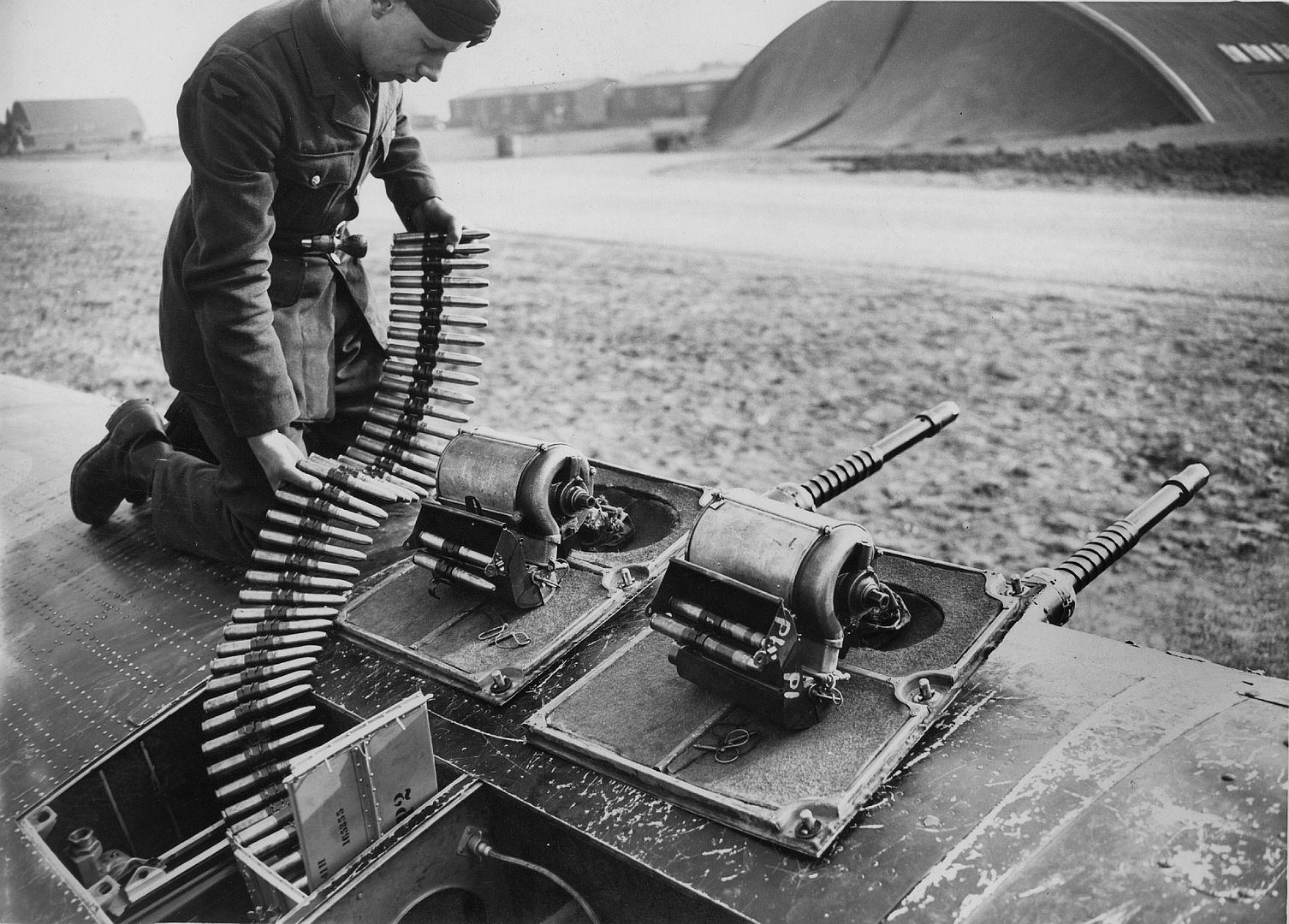

Below some wonderful shots of No. 3 Squadron RAF, Hurricane night fighters which collaborated with the Havocs . Believed to be taken at RAF Station Hunsdon.
