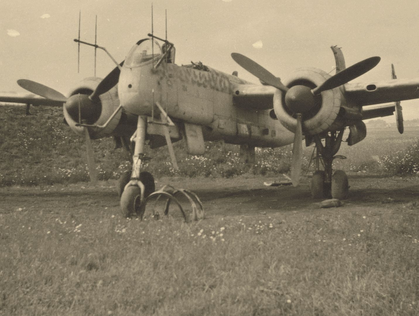

Initial deliveries went to I/NJG 1 at Venlo, on the Dutch frontier, where Streib determined to show what the type could do. It had C-1 radar, the intermediate set that followed FuG 202, and used the same group of small dipole aerials tuned to the 490 MHz frequency, but with two displays showing a direct view and a plan. The first combat mission was flown by Streib himself with backseater Pischer on the night of 11/12 June 1943 in He 219A-0 G9+FB. The mission was an epic, for the Uhu shot down five RAF heavy bombers. On returning, however, Streib totally misjudged the approach because of a misted windscreen. Seeing the dim runway lights at the last moment he selected full flap at too high a speed; the circuits shorted and the flaps blew back under the air load. The aircraft hit the ground so hard it broke up, but both men walked away without a scratch.

Subsequent He 219 sub-types are listed separately. Few of these attained production status, although features that did become standard included longer nacelles housing extra fuel, removal of the rear gun (except on the three-seat He 219A-5/R4), installation of the powerful FuG 220 Lichtenstein SN-2 radar with huge Hirschgeweih (stag's antlers) dipole aerial array, FuG 220 tail-warning radar, the ejection seat and, not least, the schräge Musik (literally 'slanting music', or jazz) armament. This scheme dated from 1941, having been proposed by armament engineers at Tarnewitz and tested by an NJG Experte, Oberleutnant Rudolf Schoenert. The idea was that oblique upward firing guns could be brought to bear accurately in a no-deflection shot by formating below and slightly behind the enemy bomber, using, a special upward looking sight. The scheme was made possible by the amazing fact that British heavy bombers not only had not one gun firing downwards but also not one window from which a formatting night-fighter could be seen. The usual schräge Musik installation in the He 219 comprised two MK 108s each with 100 rounds, fixed aft of the fuselage tanks at an angle of 65°.
