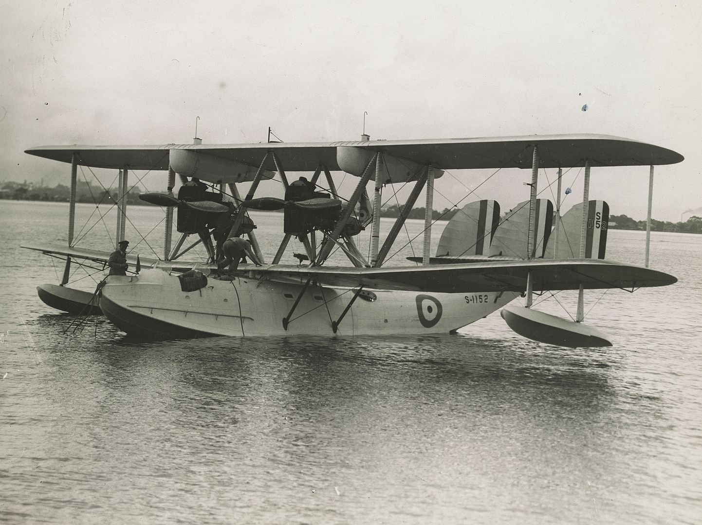

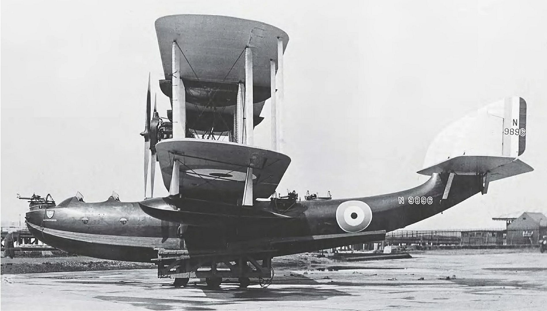

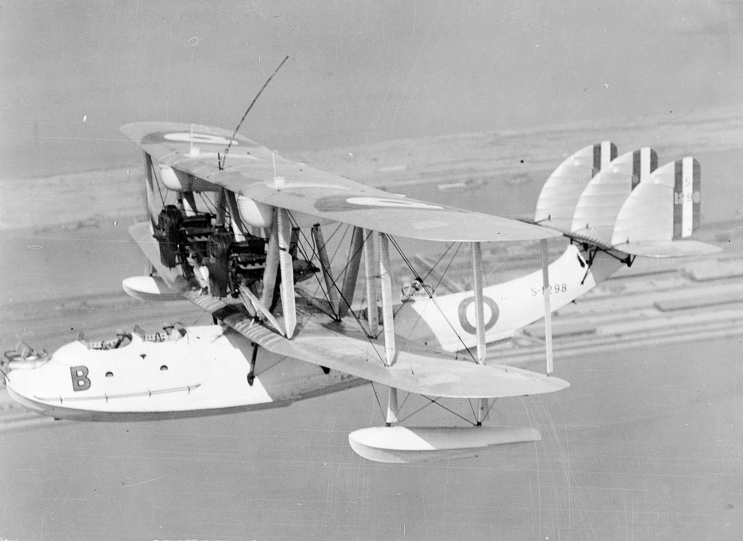

Design

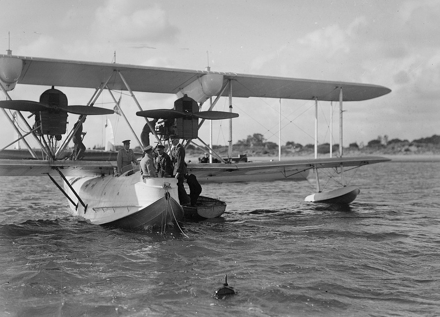

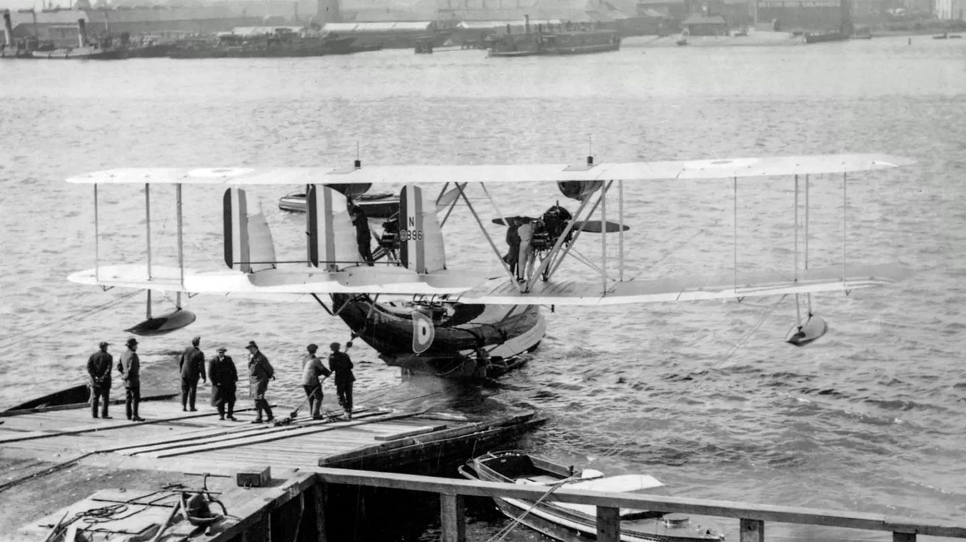

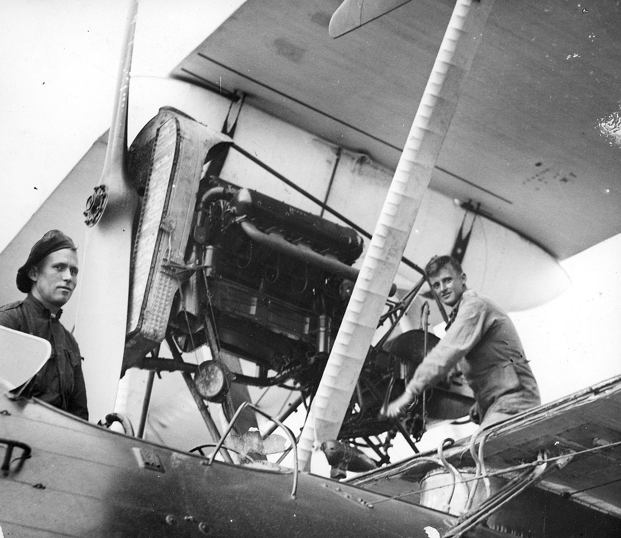

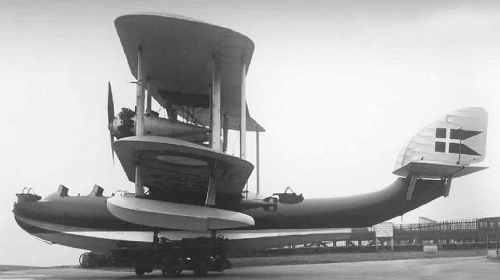

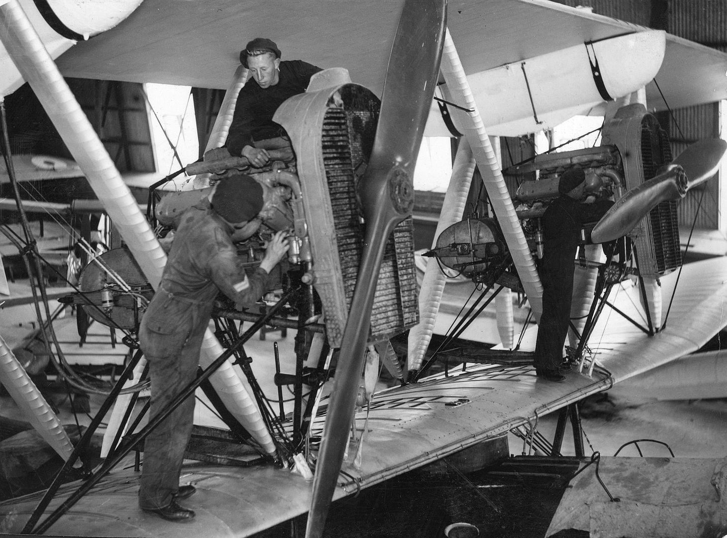

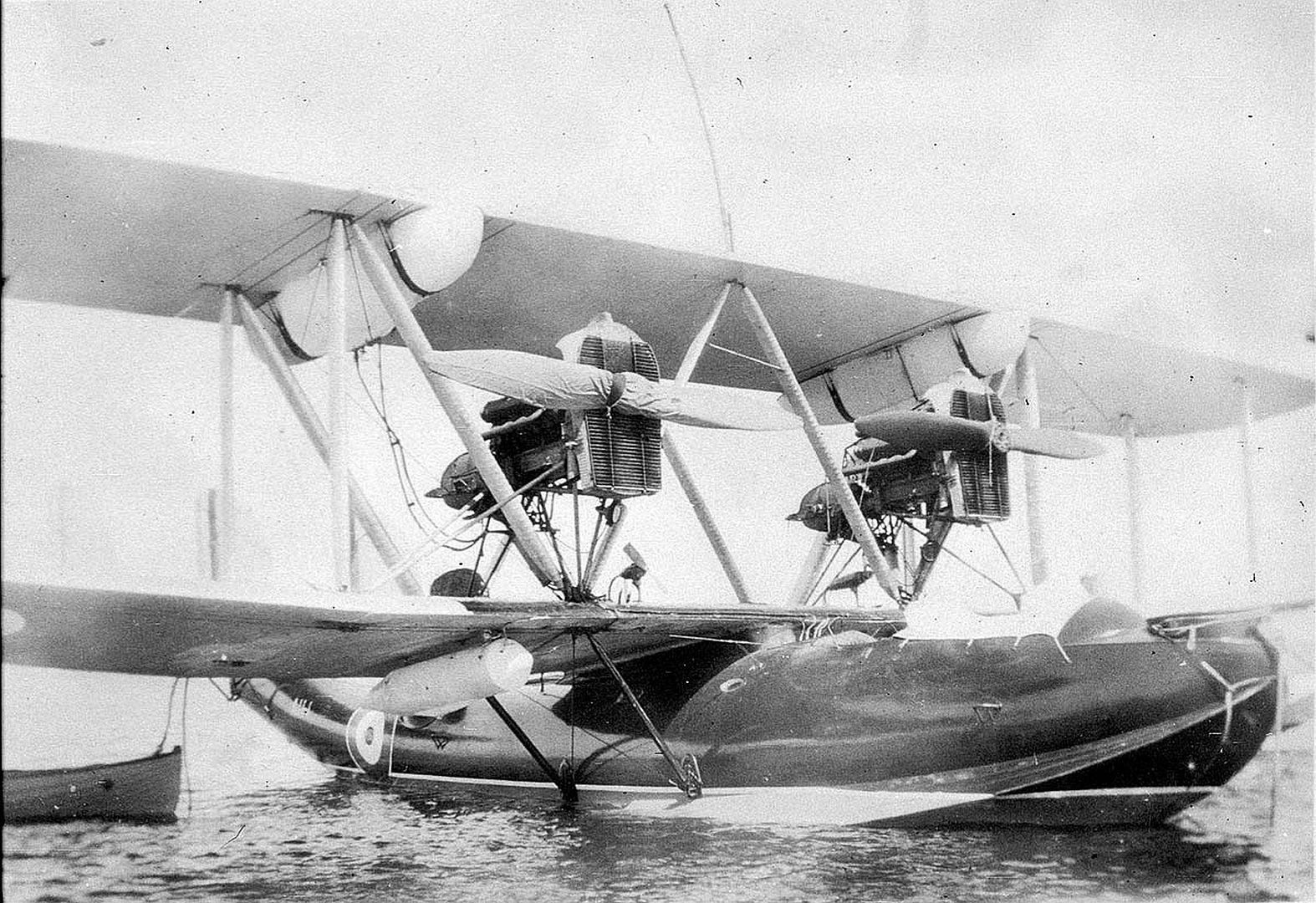

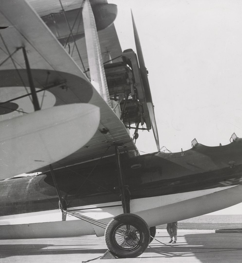

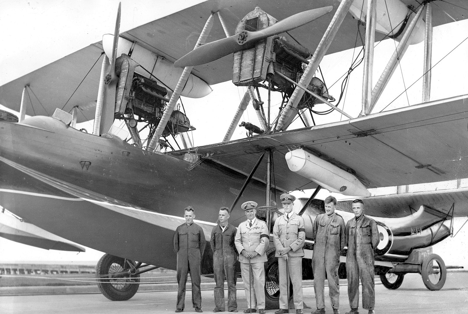

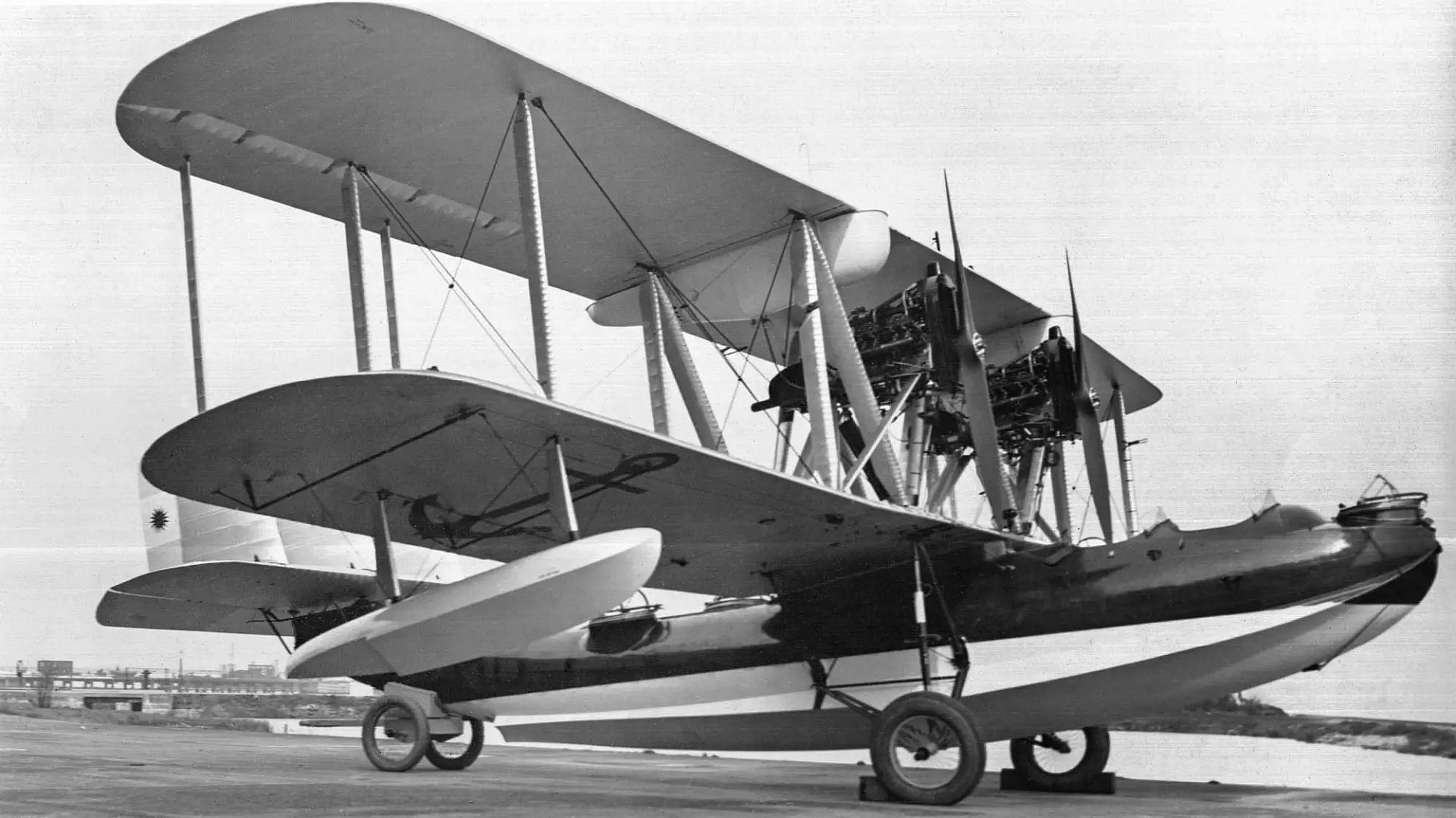

The Supermarine Southampton was a twin-engine biplane flying boat, which was typically powered by a pair of Napier Lion twelve-cylinder engines. The engines are mount on pylons positioned between the wings in a tractor configuration. The engine installation enabled both maintenance and engine swaps to be performed without any interaction with the wing structure. Fuel was gravity-fed to the engines from tanks within the upper wings, the fuselage was kept free of any fuel lines, aside from a fuel pump used to refill the wingtanks from an aft sump while at anchor. The crew were positioned so that they could readily communicate with one another. There were three positions for machine guns, one set upon the nose and two staggered towards either side of the rear fuselage. These rear gunners had a relatively favourable field of fire.

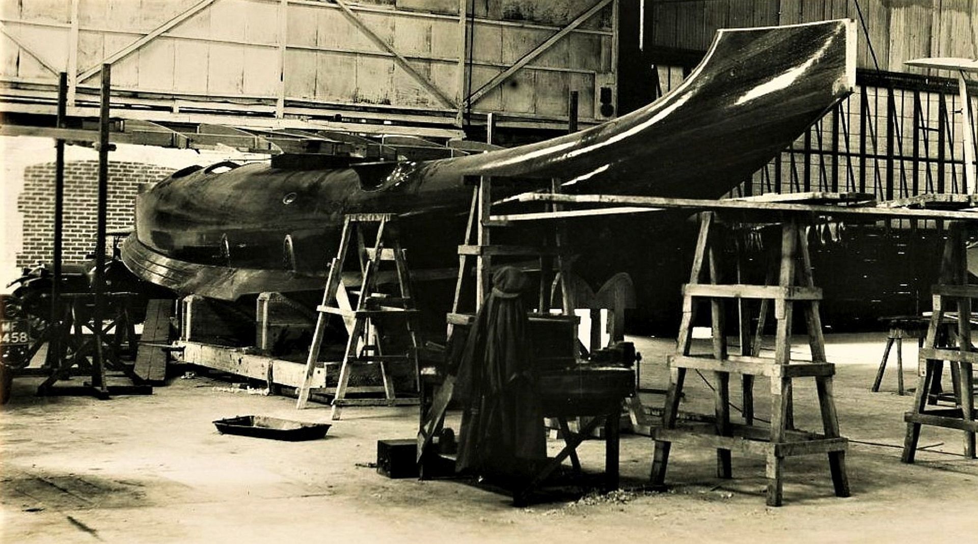

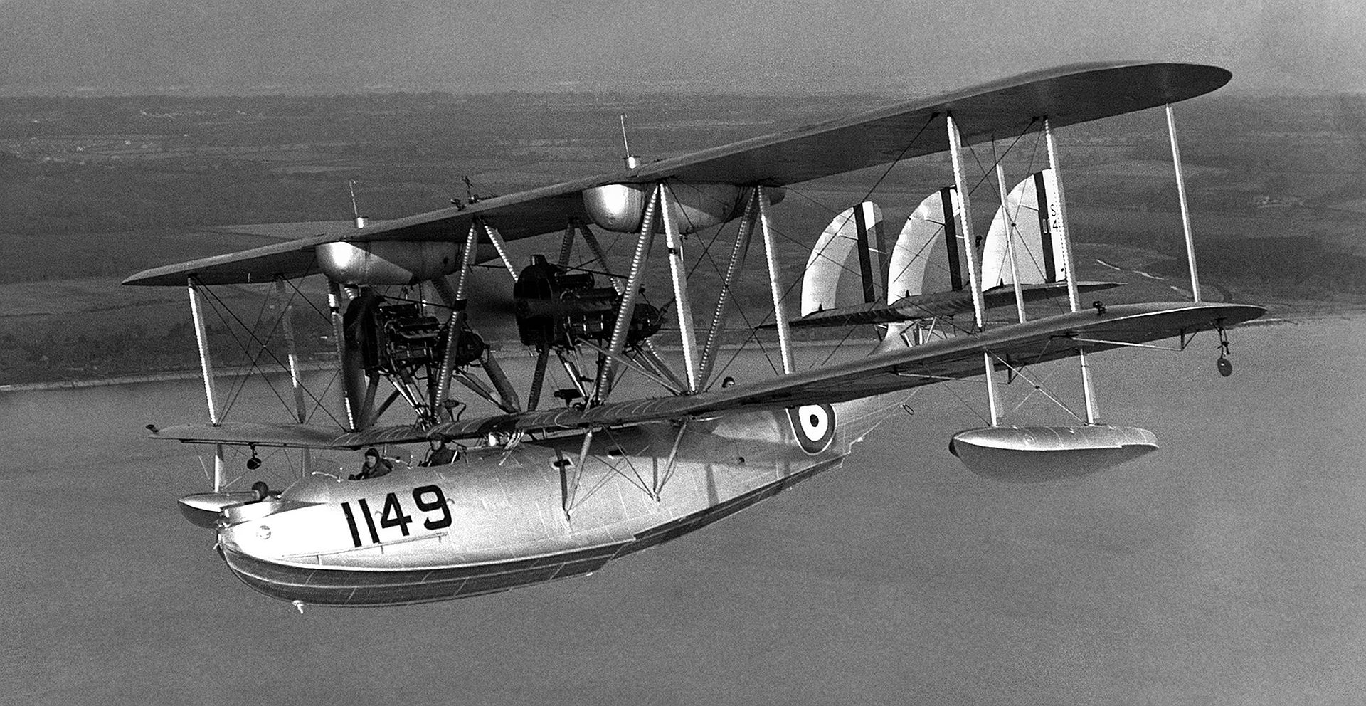

The Southampton's structure was revised substantially over successive batches. The Southampton Mk I had both its hull and its wings manufactured from wood, while the Southampton Mk II had a hull with a single thickness of metal (duralumin) (the Mk I had a double wooden bottom); this change gave an effective weight saving of 900 lb (410 kg) (of this 900 lb, 500 lb (230 kg) represented the lighter hull, while the remaining 400 lb (180 kg) represented the weight of water that could be soaked up by the wooden hull) allowing for an increase in range of approximately 200 mi (320 km). All metallic elements were anodised to deter corrosion. During 1929, 24 of the Southampton Mk Is were converted by having newly-built metal hulls replacing the wooden ones. Later on, the type was also furnished with metal propellers produced by Leitner-Watts.Some of the later aircraft were built with metal wings and were probably designated as Southampton Mk III, although this designation's usage has been disputed.

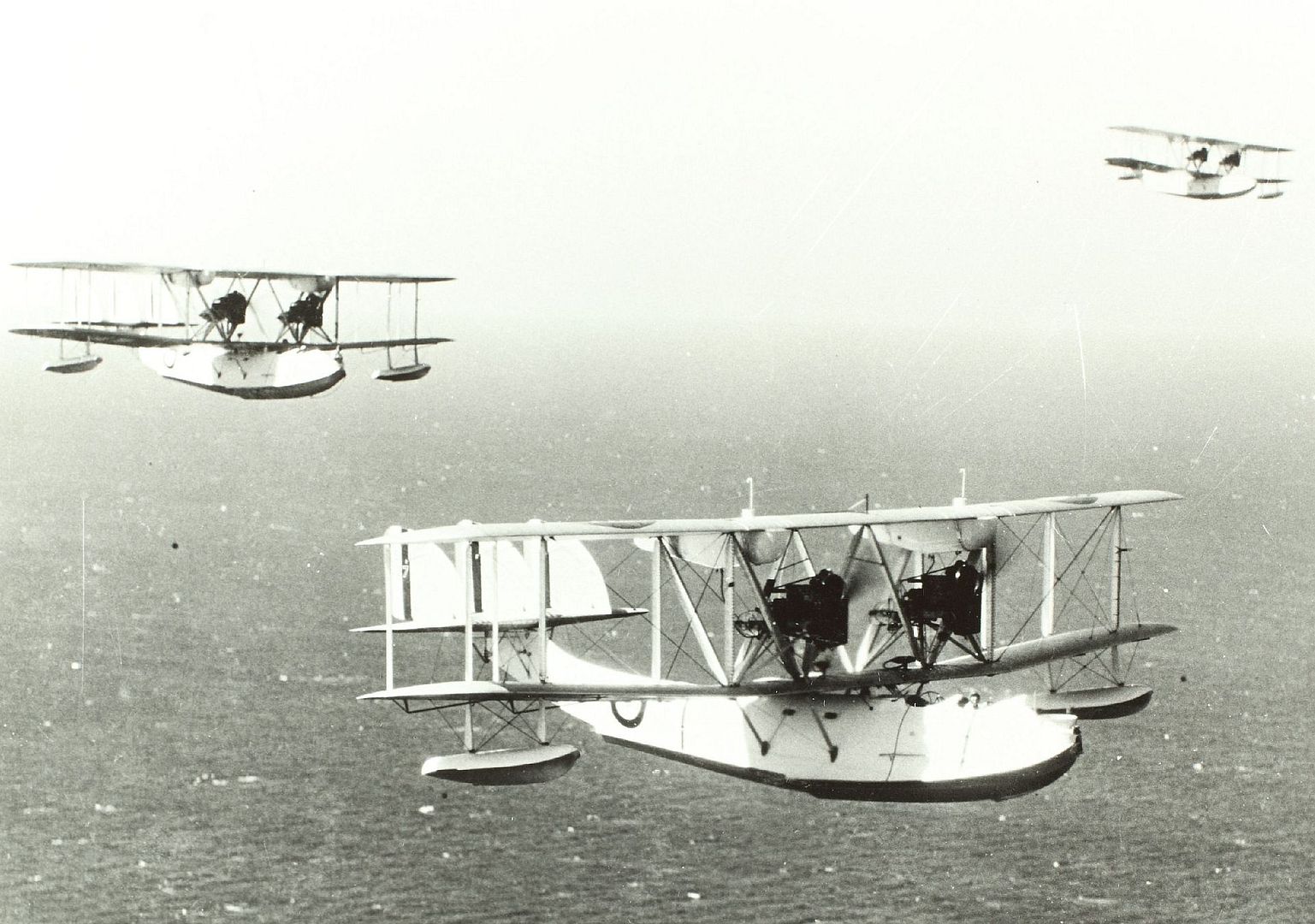

During August 1925, the first Southamptons entered service with the RAF, the type being initially assigned to No. 480 (Coastal Reconnaissance) Flight, based at RAF Calshot. As validated through a series of exercises, the ability of the Southampton to independently operate, even within inhospitable weather conditions, was well proven. Andrews and Morgan observed that the Southampton quickly proved itself to have primacy amongst European flying boats of the era, a fact that was promptly demonstrated by its overseas activities.

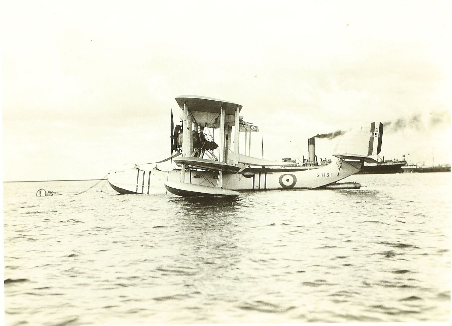

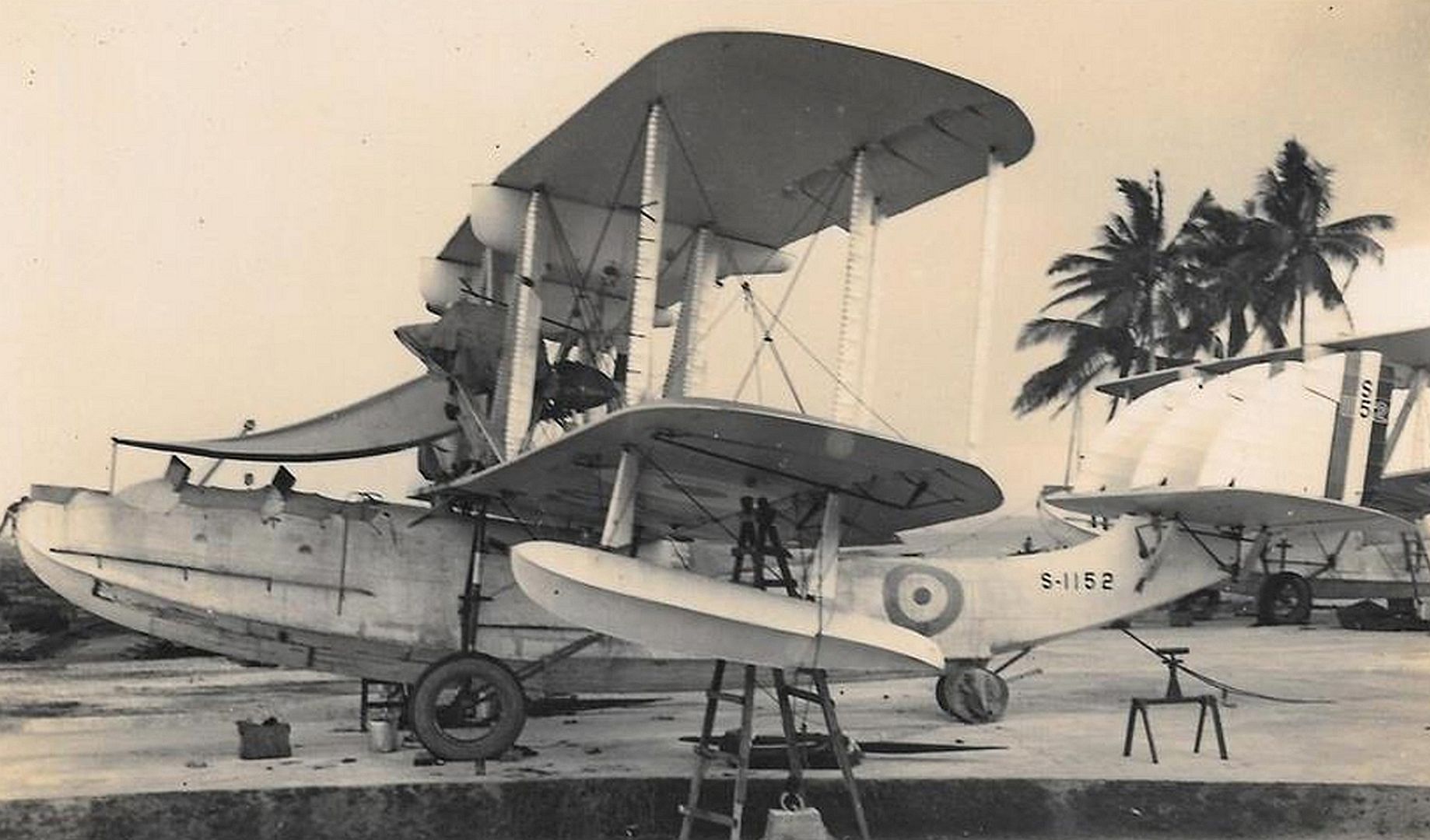

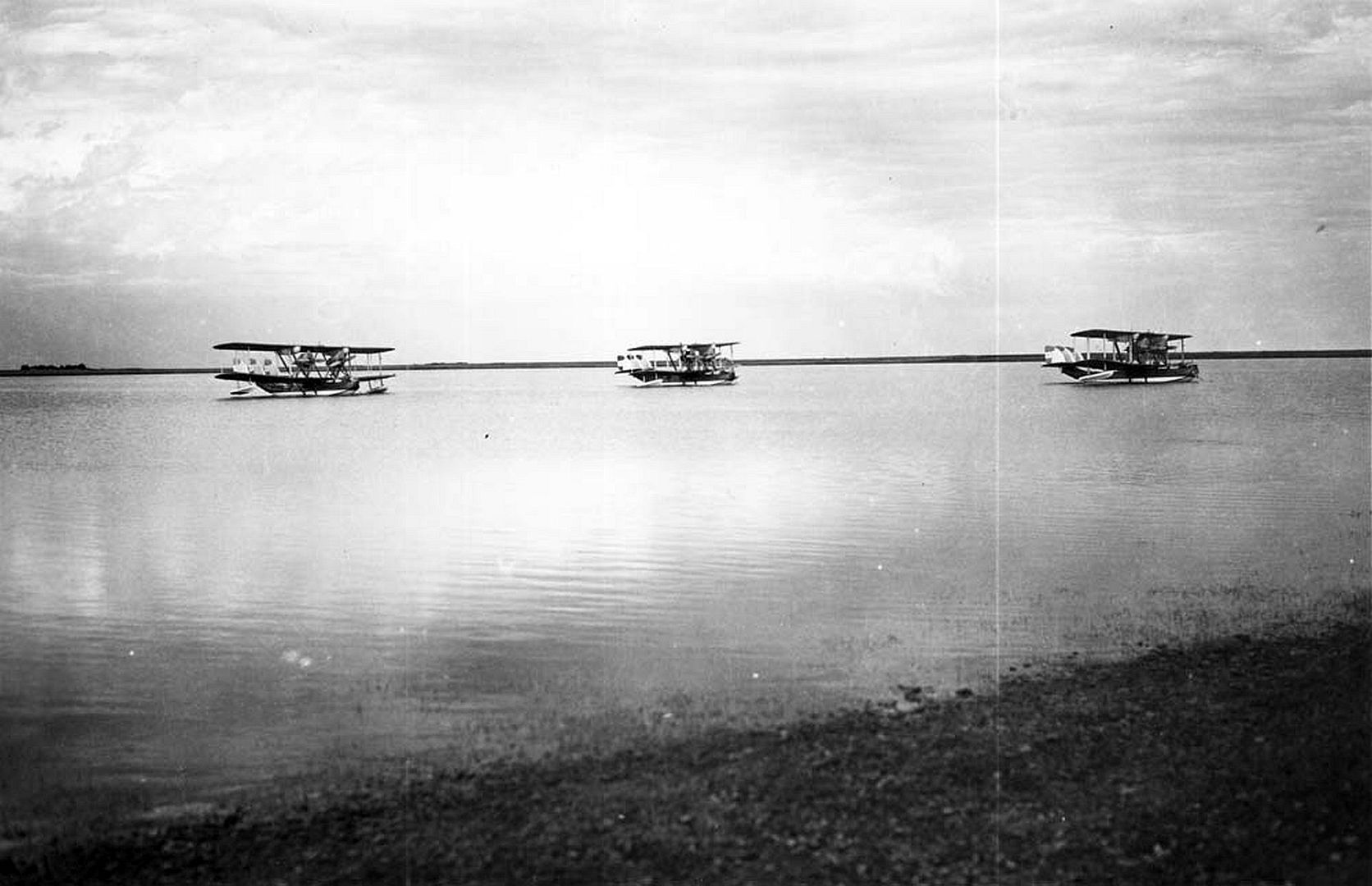

Amongst the tasks of which RAF Southamptons performed was a series of "showing the flag" long-distance formation flights. Perhaps the most notable of these flights was a 43,500 km (27,000 mi) expedition conducted during 1927 and 1928; it was carried out by four Southamptons of the Far East Flight, setting out from Felixstowe via the Mediterranean and India to Singapore. These aircraft featured various technical changes, including enlarged fuel tanks composed of tinned steel, increased oil tankage, greater radiator surface area, and the removal of all armaments. According to Andrews and Morgan, the Southampton acquired considerable fame amongst the general public from these flights; Supermarine also shared in this reputation gain. There were also practical benefits of these flights, as new anti-corrosion techniques were developed as a result of feedback.

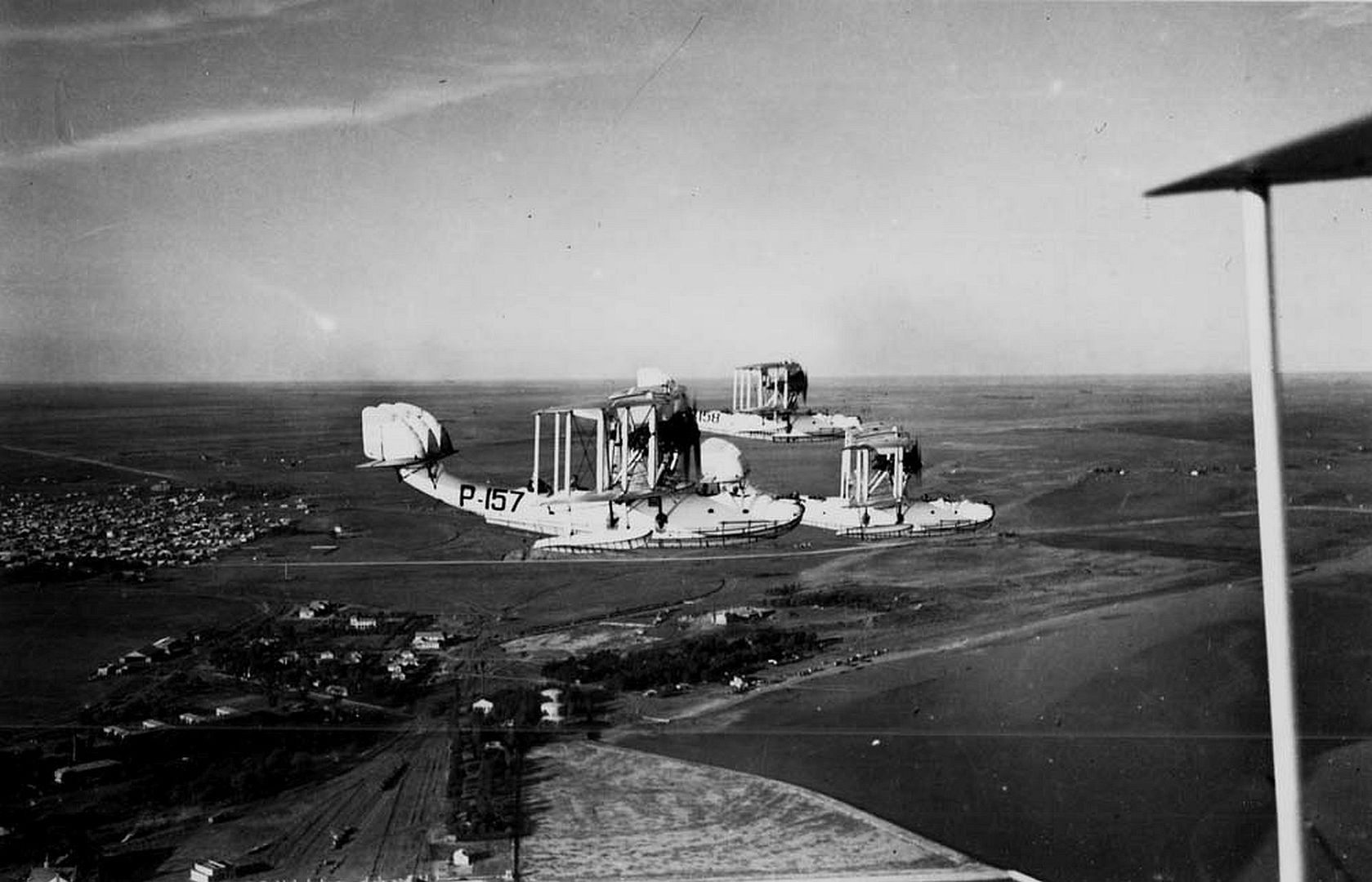

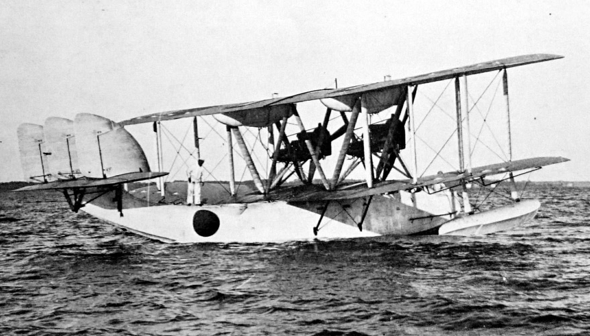

While the RAF was the type's most high-profile customer, further Southamptons were sold to a number of other countries. Eight new aircraft were sold to Argentina, with Turkey purchasing six aircraft and Australia buying two ex-RAF Mk 1 aircraft. Japan also purchased a single aircraft which was later converted into an 18-passenger cabin airliner. The United States Navy also requested a quote, but no order materialised. One RAF aircraft was loaned to Imperial Airways, with British Civil Registration G-AASH(some scources say G-AAFH) sat, for three months from December 1929 to replace a crashed Short Calcutta on the airmail run between Genoa and Alexandria.

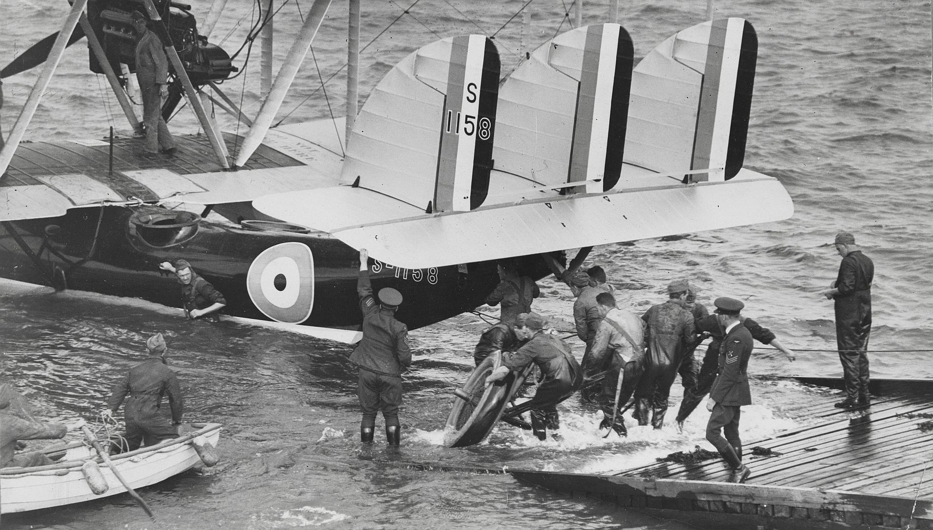

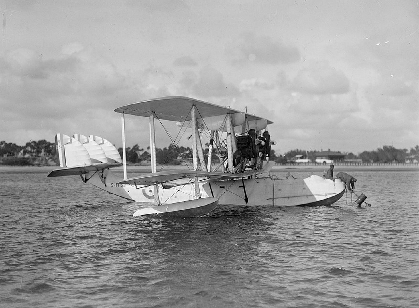

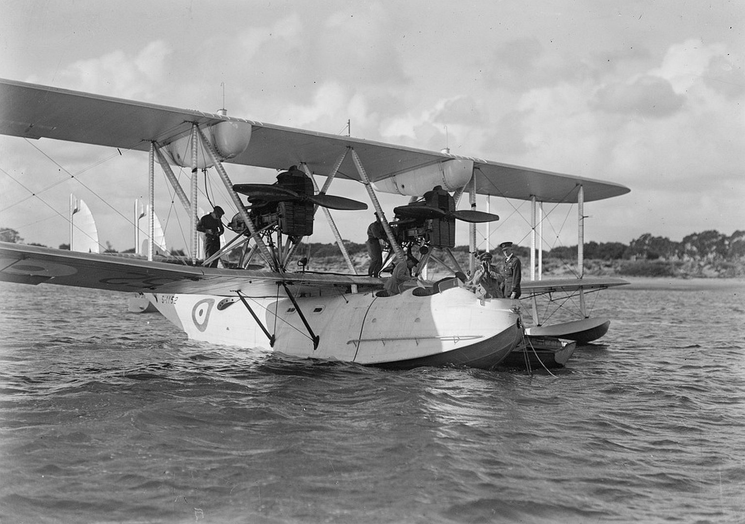

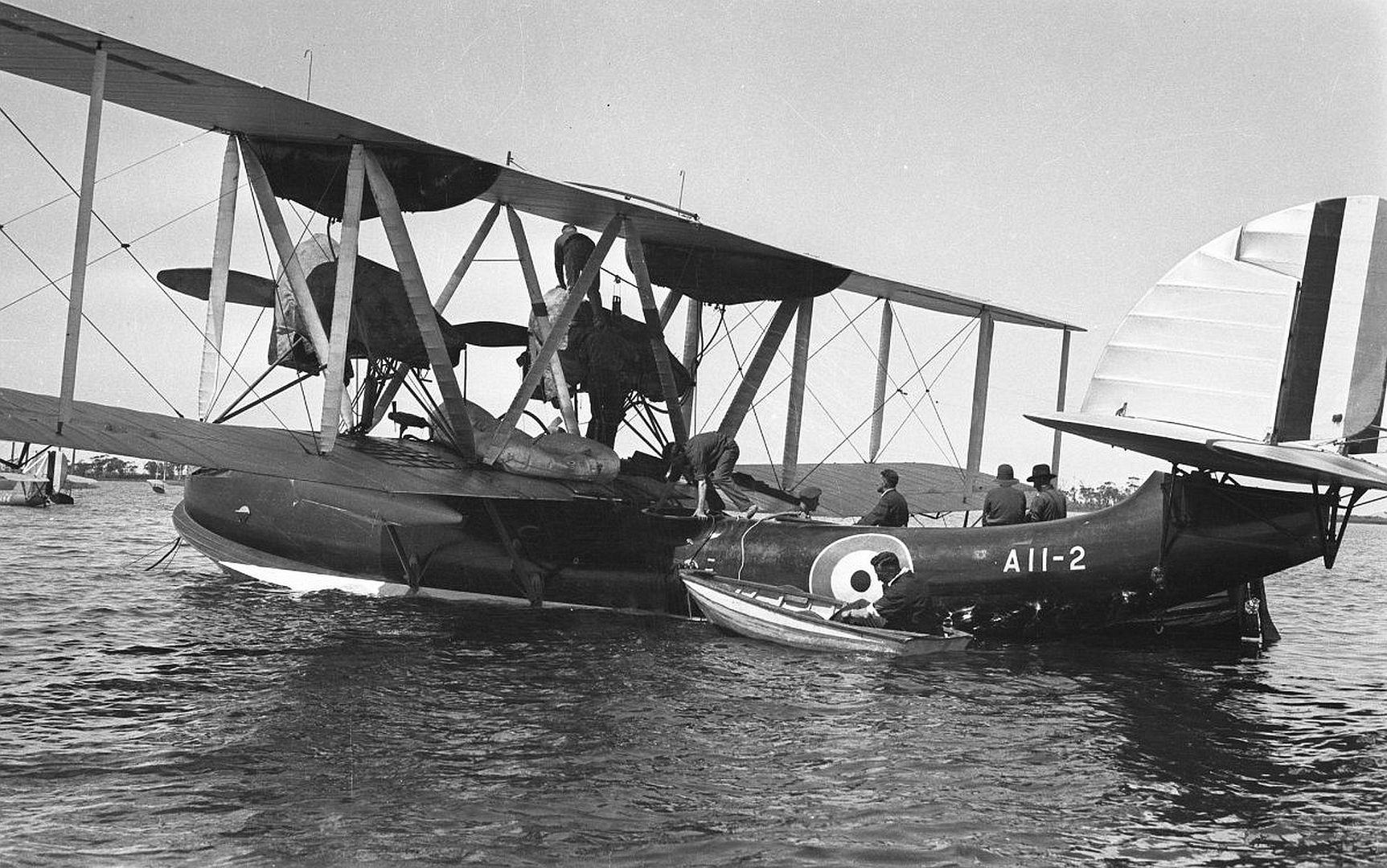

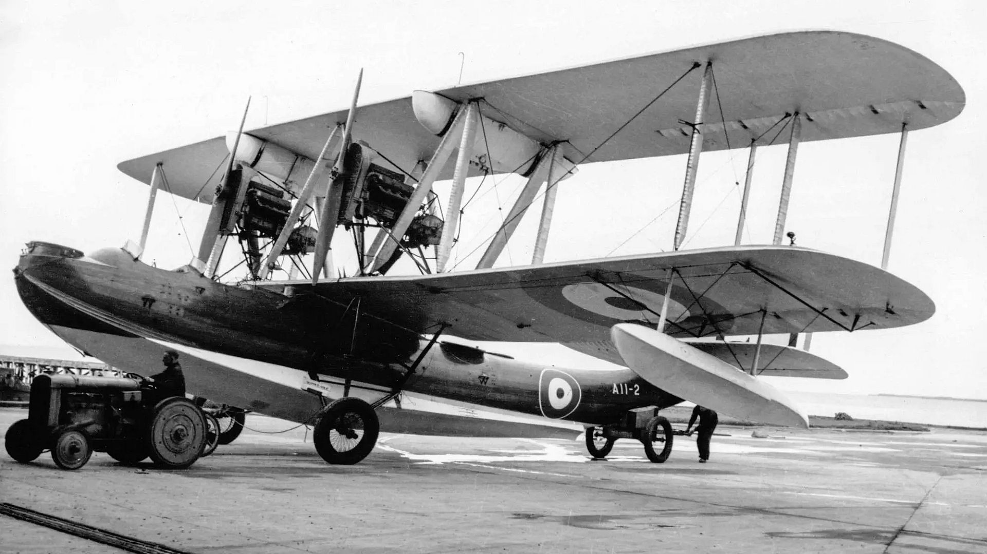

Two Ex-RAF Singapore I aircraft were sold to Australia (S1158, S1159 becoming A11-1 and A11-2, respectively) and these aircraft were intended to take part in the RAF Far East Flight’s circumnavigation of Australia. One aircraft (A11-1) was pre-positioned to greet the RAF Far East Flight at Adelaide SA in June 1928. Sadly however, a freak gust of wind overturned the aircraft as it was about to leave to meet up with the RAF flight.

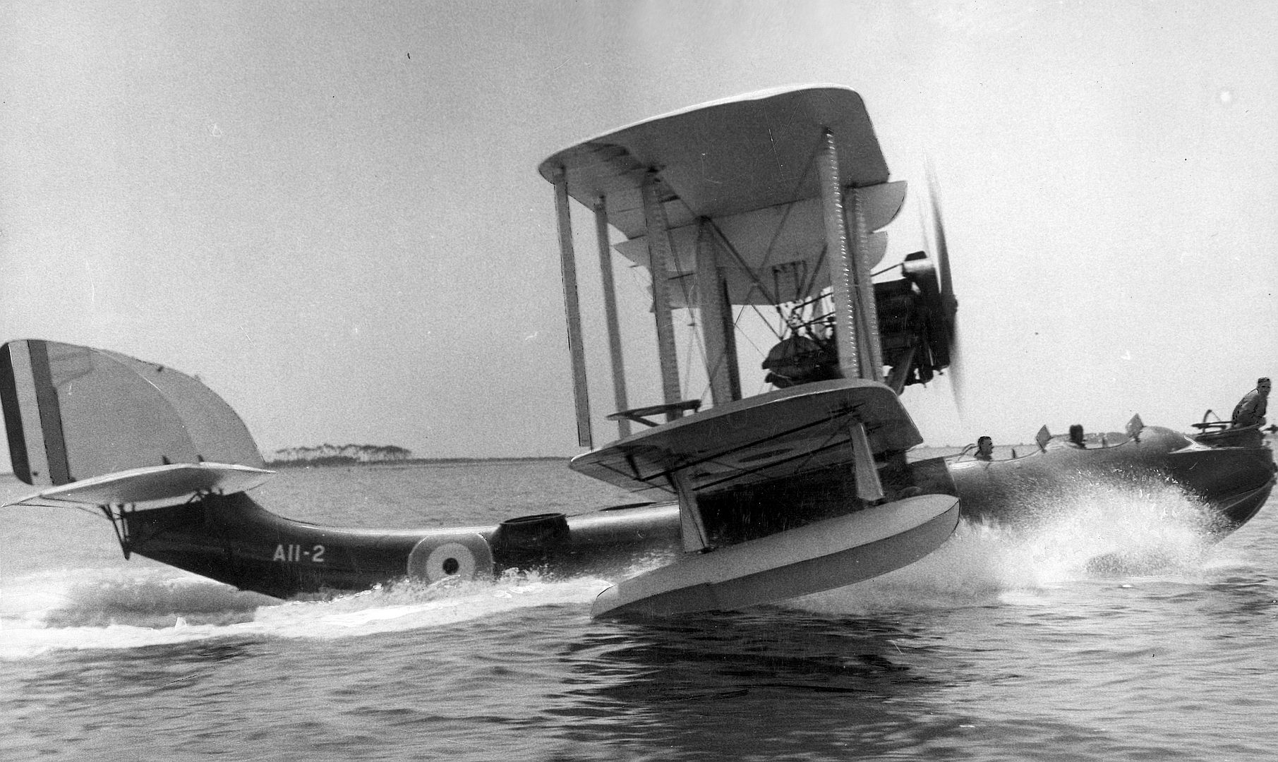

One Vickers Supermarine Southampton (A11-2) subsequently set off on a tour of the major cities of the eastern Australian States, an expedition which generated very positive publicity for the RAAF. Consequently, similar recruitment tours became a regular occurrence during 1929-33 period, with one of the aircraft undertaking such a task every six months or so.
In Australian service, the type proved to be very popular with aircrews due to the combination of a galley and sleeping area. It also found favour as a reliable, stable flying platform that earned high praise from those undertaking long range flights as well as those who maintained them.
