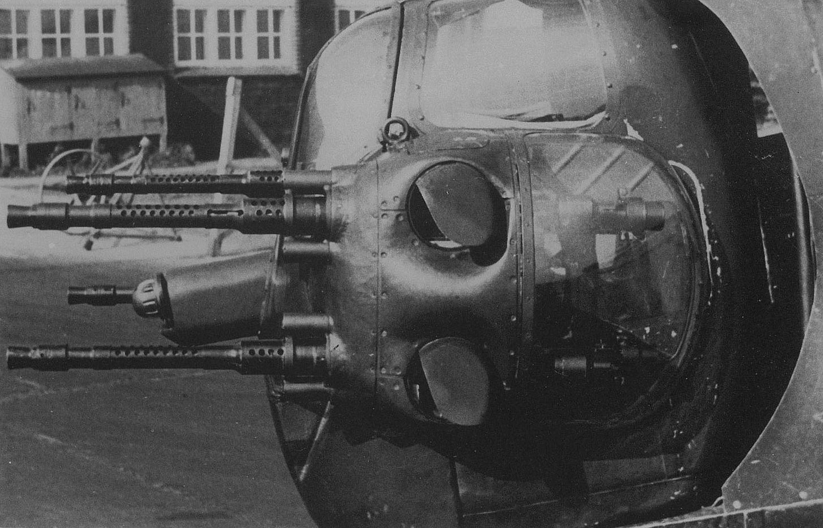

Günter's original intention had been to equip the He 177 with three cockpit-controlled remote gun turrets, with two of them to come from the Junkers Ju 288 program, leaving one manned emplacement in the tail. Compared with the manned position, a remotely controlled, turreted defensive armament emplacement system traded technical complexity for reduction of size, weight and drag; it had the advantage that the gunner could be placed in a protected position, with the best possible view and with less risk of being blinded by the flash from his own guns. Although work on remotely controlled aircraft defensive systems had reached a relatively advanced stage in Germany in the late 1930s, progress in this field within Germany's aviation and armaments systems engineers and manufacturers was to prove insufficient to keep pace with the He 177. As a result, the He 177 had to be modified to accommodate larger and heavier manned positions, such as the manned rear dorsal turret usually fitted to almost all examples of the Greif, armed with a 13 mm MG 131 machine gun. That installation meant that the fuselage had to receive structural strengthening in several locations. Most of the later production aircraft did receive a remote forward dorsal turret, the Fernbedienbare Drehlafette (translated as "Remotely operated rotating gun-mount" and abbreviated "FDL") 131Z, armed with two MG 131 machine guns, located at a point on the fuselage directly above the wing root's leading-edge, with its rotating hemispherical sighting station dome located a short distance forward of the turret and slightly offset to starboard, just behind the forward cabin area.
A compact tail gun position was fitted for rearward defense, armed with one MG 131 machine gun but its streamlined glazing meant that the gunner lay prone, severely restricting his comfort on long missions. A revised tail gun position with a bulged upper glazing was fitted to the He 177A-3 and later models, which permitted the gunner to sit upright. The revised design required a reduction of the lower end of the rudder surface for clearance. The MG 131 gun would often be replaced with a 20 mm MG 151 cannon or in a few instances, a semi-experimental twin MG 131Z mount, with the twinned 13 mm calibre guns mounted one above the other, at the rear of the standard bulged upper glazing emplacement. Usually, a 7.92 mm MG 81 machine gun in a flexible mount was positioned in the upper starboard side of the cockpit nose glazing for defense against frontal attacks. The undernose, inverted-casemate Bola gondola (a common ventral armament fitment on many German bombers), which was the full width of the fuselage where it emerged from under the nose and centered under the forward cabin, usually had a flexibly mounted, drum-fed 20 mm MG FF cannon at the front end as added forward defense and a flexibly mounted MG 81 machine gun in the rear, for the initial He 177A-1. An MG 151 cannon replaced the forward MG FF cannon in later production models, with an MG 131 usually replacing the MG 81, for rearwards ventral defense.

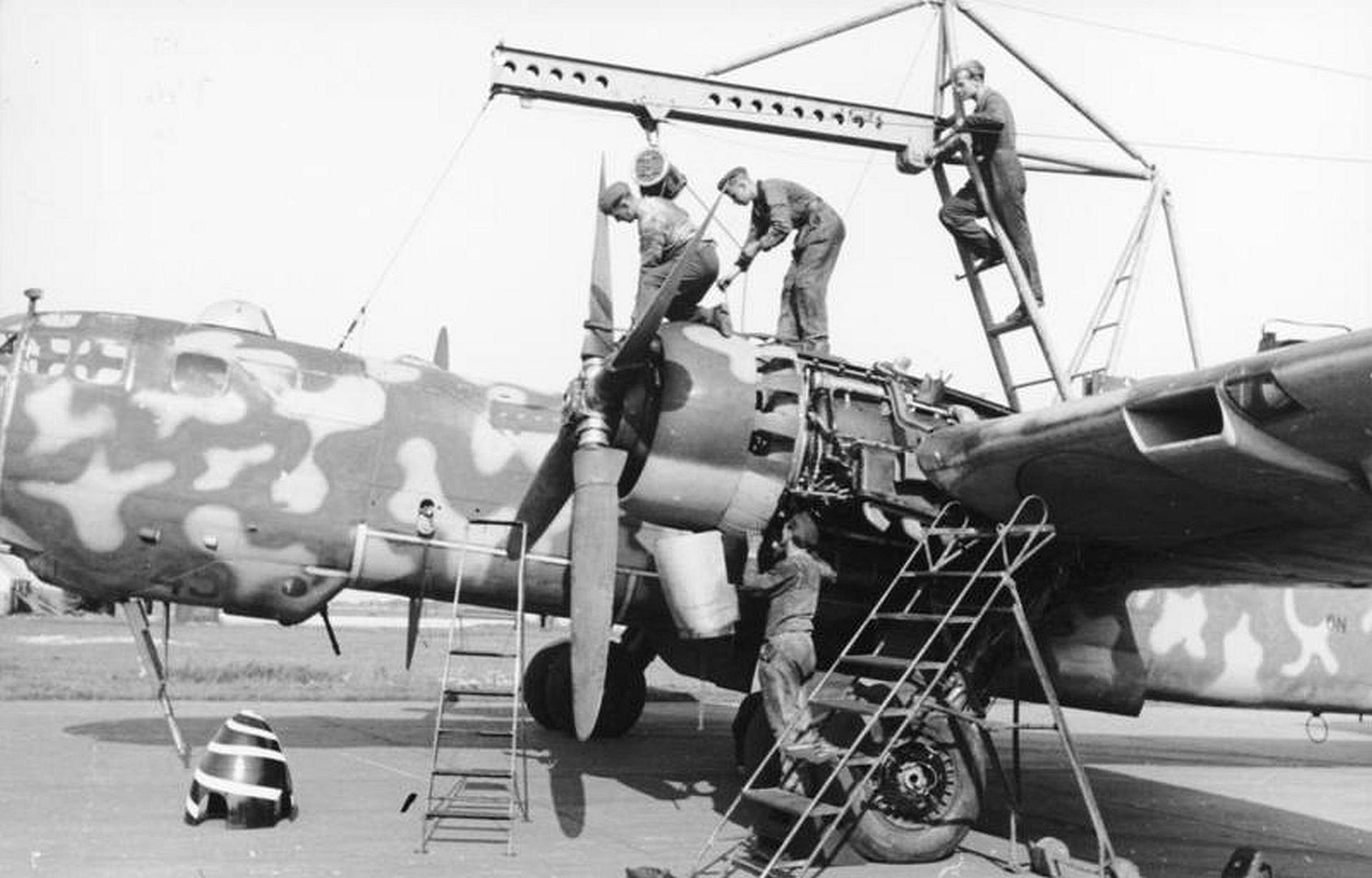

The tendency of the twin-crankcase, 1.5 metric tons (1.7 short tons)-apiece DB 606 "power system" engines to catch fire became increasingly serious as the test programme progressed, and many of the He 177A-0 series of pre-production prototypes were destroyed in accidents or engine related incidents. The DB 606 engine had first been introduced on the Heinkel He 119 and later used on other aircraft such as the Messerschmitt Me 261 where they functioned as intended, but the extremely tight cowlings on the He 177A led to considerable problems, the most common being in-flight engine fires and engine overheating. There were several reasons for the flammability of the DB 606 engine as installed in the Greif engine nacelles. One was the common "central" exhaust manifold, serving a total of 12 cylinders, on the two inner cylinder banks of the twinned DB 601 component engines making up a DB 606. This central exhaust system routinely became excessively hot, causing the usual accumulation of oil and grease in the bottom of the engine cowling to catch fire. When the pilot throttled back there was a tendency for the mechanical fuel injection pump on each component DB 601 engine to "lag" in its response, delivering more fuel than was required by the engine. In addition, the fuel injection pump connections often leaked. To reduce the aircraft's weight, no firewall had been provided, and the aft end of each DB 606 was fitted so close to the main spar — with the rear two-thirds of the component powerplants' engine blocks being placed behind the wing's leading edge — that there was insufficient space for the fuel/oil fluid lines and electrical harnesses. The engines' exterior surfaces within the cowlings were frequently saturated with fuel and oil from leaking connections. At high altitude the oil tended to foam due to a badly designed oil pump, reducing its lubricating qualities. Insufficient lubrication caused disintegration of the connecting rod bearings, which sometimes resulted in conrods bursting through either one of the component engine crankcases and puncturing oil tanks. The oil would then spill on to the often-overheated central exhaust pipe collector. The tightly packed nature of the "power system" engine installations on the He 177A, with the extreme rearwards location of the component engines in their nacelles, also led to poor maintenance access as well as very poor ventilation. As a result of these factors, in addition to a lack of routine maintenance in the field, the DB 606 powerplants frequently caught fire in flight. The mechanical coupling of two engines proved to be difficult to perfect and led to numerous engine complications with the service test He 177A-0 and initial production A-1 models.
By early August 1942 Göring became angry about the apparent slowness with which the He 177A's powerplant problems were being dealt with. He received a report by Oberst Edgar Petersen (Kommandeur der Erprobungstellen; "commander of test facilities") about the He 177A's powerplant troubles, particularly containing remarks about the problems caused by the compromised design of the DB 606 powerplants' accommodation in the He 177A's engine nacelles, and resultant poor maintenance access. On August 13, Göring responded:
"Why has this silly engine suddenly turned up, which is so idiotically welded together? They told me then, there would be two engines connected behind each other, and suddenly there appears this misbegotten monster of welded-together engines one cannot get at!"
Starting with the He 177A-3/R2, the engines and nacelles were redesigned to eliminate the tendency for engine fires. The new "power system" was the Daimler-Benz DB 610, which consisted of two Daimler-Benz DB 605s coupled into a single unit like the DB 606. With the introduction of the DB 610 came several improvements, including the relocation of the engine oil tank, a changed oil flow pipe, an improved oil cooler, the lengthening of the engine mountings by 20 cm (8 in), the complete redesign of the exhaust system, which also facilitated the installation of exhaust flame dampers for night missions, and the setting of a power limitation on the engines which resulted in greater reliability. These major and minor modifications, supposedly numbering 56, were successful in eliminating engine fires, but other minor problems remained, involving the transfer gearbox fitted across the front ends of the "twinned"-component engines of each "power system" and their shared propeller.
