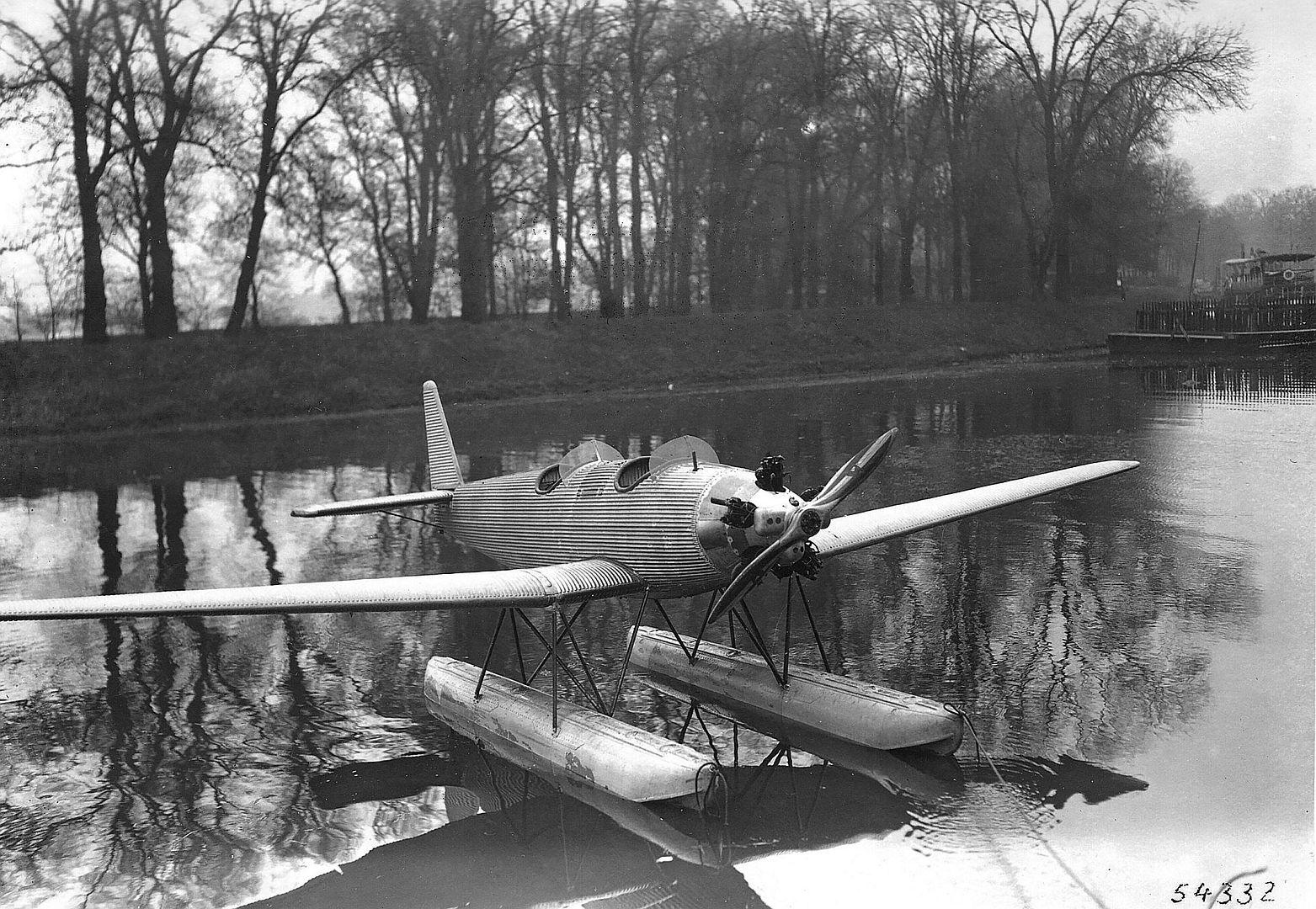

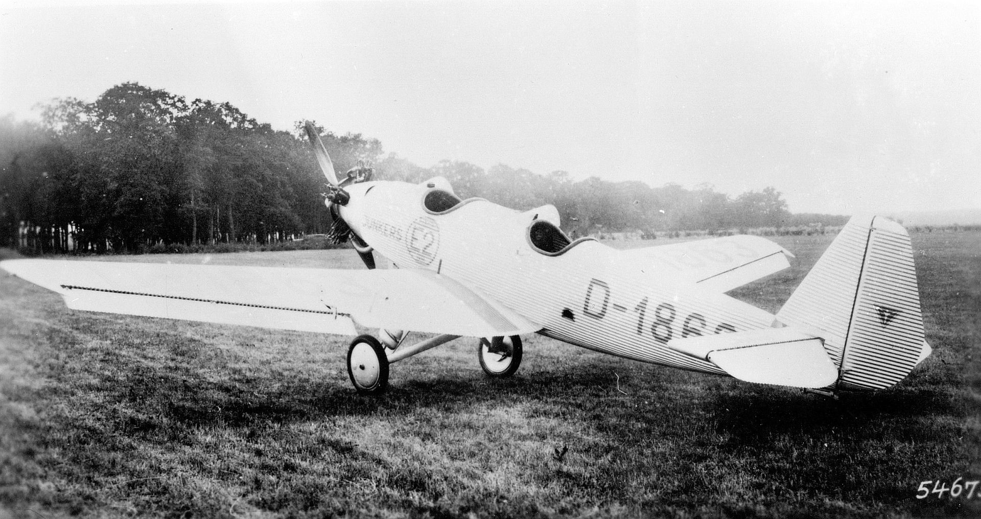

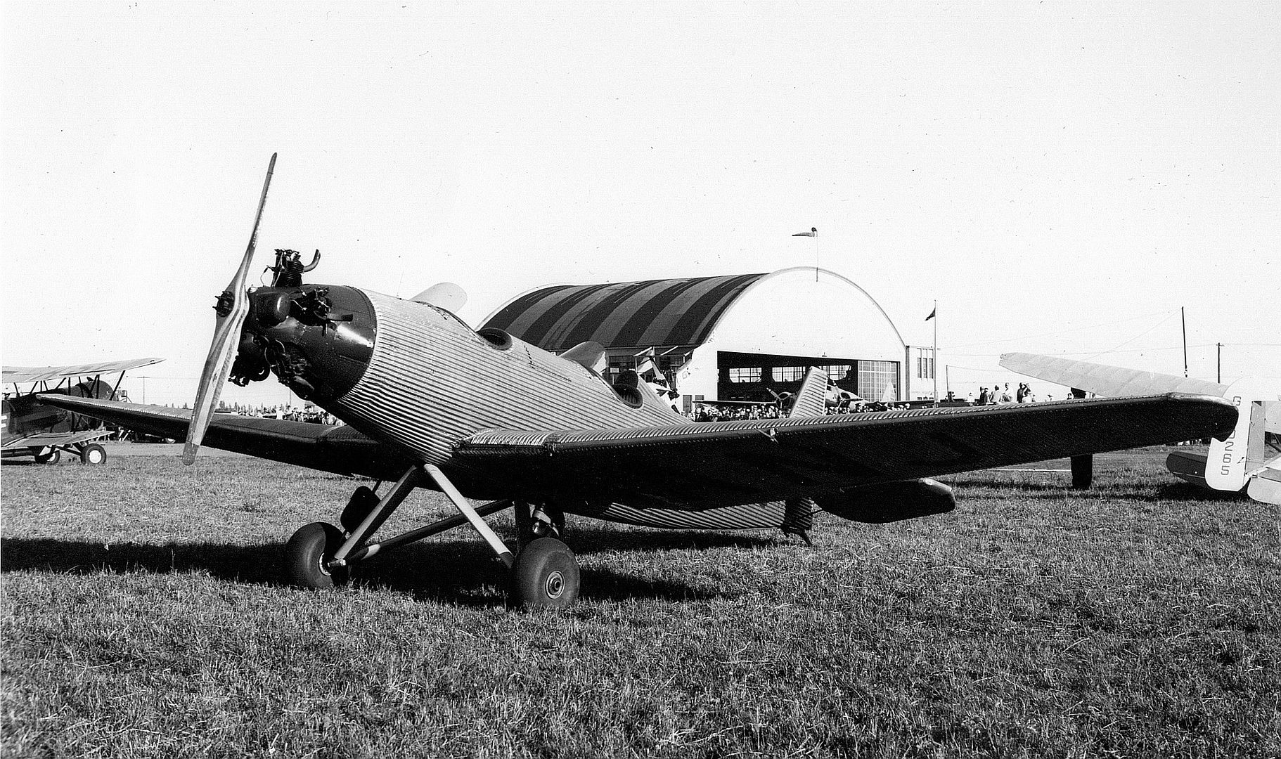

The Junkers A50 was a sports plane that featured a conventional configuration, all-metal construction, a low-mounted cantilever wing, and a stressed corrugated duralumin exterior.It was promoted for its adaptability, being as equally suitable for use during summer as it was during the winter, on land or at sea, and in the tropics or near-artic conditions.The A50 conformed with several conventions for Junkers-built aircraft, such as the placement of the pilot in the rear seat while the passenger sat in the forward position. Both positions were provided with dual flight controls and two complete sets of instruments.

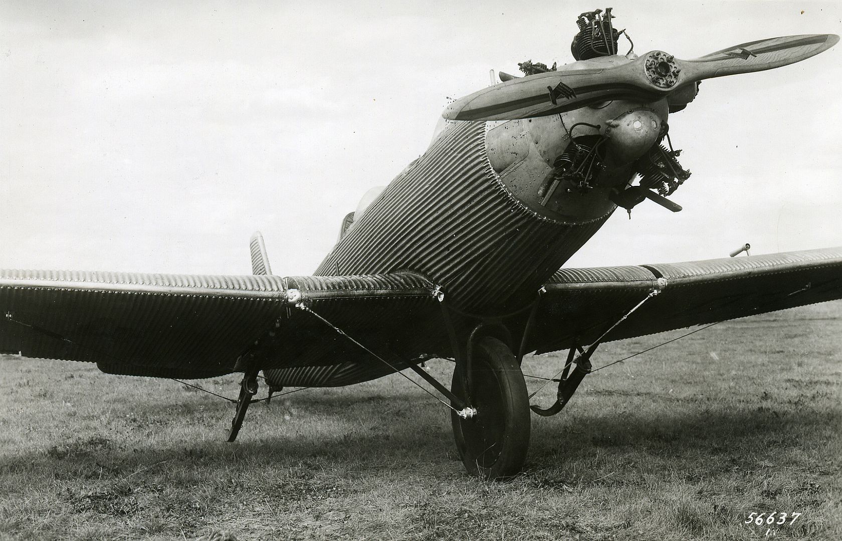

The fuselage was a precisely streamlined tube of corrugated duralumin; in spite of its extensive use of metal, it was carefully designed so that achieved the typical weight limits of mixed-construction aircraft (e.g. those that used fabric and wood). It was supported by a number of formers and bulkheads that had provisions for easy access that permitted both inspection and repairs to be performed.The nose of the fuselage accommodated the aircraft's single engine while the rear of the fuselage tapered into a vertical wedge that extended upwards to form the fin.
Having been designed to serve as a touring aircraft, several aspects of the aircraft, such as the comfort and convenience of the occupants, were addressed in detail. The two seats present in the cockpit, used by the pilot and a single passenger, were relatively well-upholstered, broad, and fitted with an adjustable back and arm rests. Two separate baggage compartments were provided for the carriage of even particularly heavy suitcases; one, positioned between the two seats, was within easy reach of either occupant throughout the flight. The second baggage compartment, behind the pilot's seat, was large enough for a single streamer trunk. Piping in the vicinity of the cockpit was concealed by the aircraft's double bottomed fuselage.

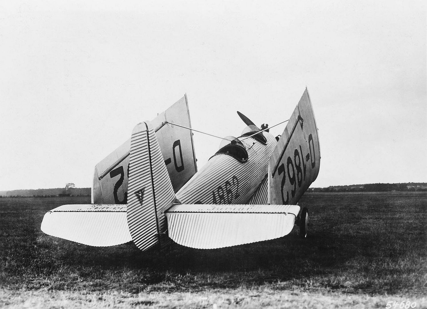

The wing was divided into a central section, which was integral with the fuselage, and two outer sections that were joined to the centre using no more than four screws each; this aided ground transportation as well as repair work, the outer sections being readily replicable by a substitute. Akin to the fuselage, the wing was covered in stressed corrugated duralumin. Structurally, it was relatively simplistic, dispensing with many typical supporting devices, such as ribs; this simplicity benefitted both production and service staff alike. Several mundane defects, such as bulges, were felt to be reasonably addressable by the owner themselves. For more space-efficient storage of the aircraft, the wings could be folded rearwards on some models.
It had a two-part elevator that was hinged to the stabilisor; it could be adjusted while on the ground. The rudder was hinged to both the fin and the tip of the fuselage. The elevator, rudder and ailerons all used ball bearings, which were relatively easy to operate and service.The aircraft's proportionally large flight control surfaces, thus only necessitating slight deflections, were actuated using a series of adjustable push rods. The forces and deflections of the control stick and rudder bar were harmonised. It was considered to be an easy enough aircraft to fly that it would be suitable for training beginning pilots.

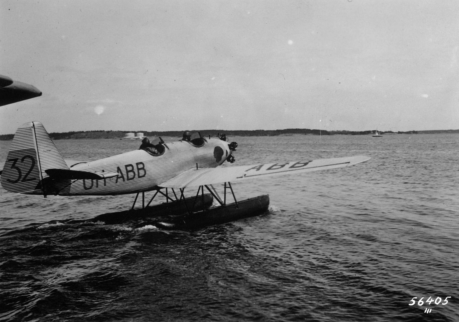

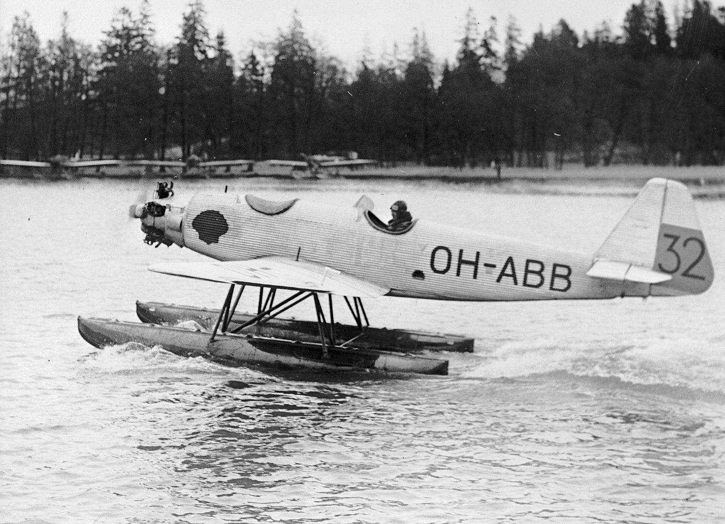

The aircraft could be alternatively furnished with either conventional landing gear, skis or floats without the use of any special fittings.The floats were relatively large, to the extent that the aircraft could remain afloat if only one of them were to be attached; to maximise buoyancy in the even of damage, the floats had internal bulkheads that formed multiple water-tight compartments. Whichever undercarriage was opted for, it would be attached to supporting points underneath the centre section of the wing.The landing gear had a relatively wide track, which reduced the likelihood of the winds making contact with the ground, and lacked a continuous axle, which hindered ground movements in the presence of long grass or undergrowth. The rudder effectively offset the traditional manoeuvrability penalty incurred by the use of wide track landing gear. The wheels were relatively large and sturdy, and thus suitable for use on unprepared or austere airstrips. Furthermore, the landing gear was furnished with rubber-cable style shock absorbers that were designed for durability.
It was typically powered by a single Armstrong Siddeley Genet II air-cooled radial engine, which was mounted on an easily-removable frame upon the forward bulkhead, which functioned as a firewall. It possessed considerable reserve power and reliability, which led to its selection to power the aircraft. The engine was enclosed by smooth sheet duralumin that left only the cylinder heads exposed. The propeller was directly-driven by the engine. A special starter that involved the injection of atomized fuel into the intake manifold and a light magneto. Fuel was stored in two primary tanks in the centre section of the aircraft; it was supplied to a single gravity tank via a fuel pump. The oil tank was directly adjacent to the gravity tank.
