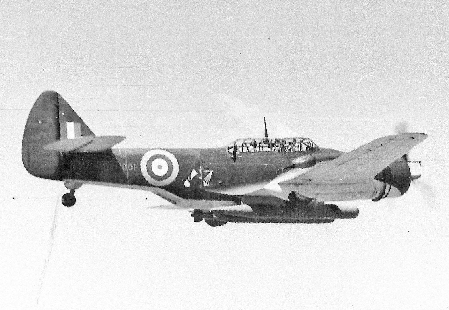

Main AdminIn April of 1940 the RAAF issued Specification no.241 based on Wackett’s proposal. This called for an aircraft suitable for reconnaissance, level-and-dive bombing, as well as the ability to act as a torpedo bomber.

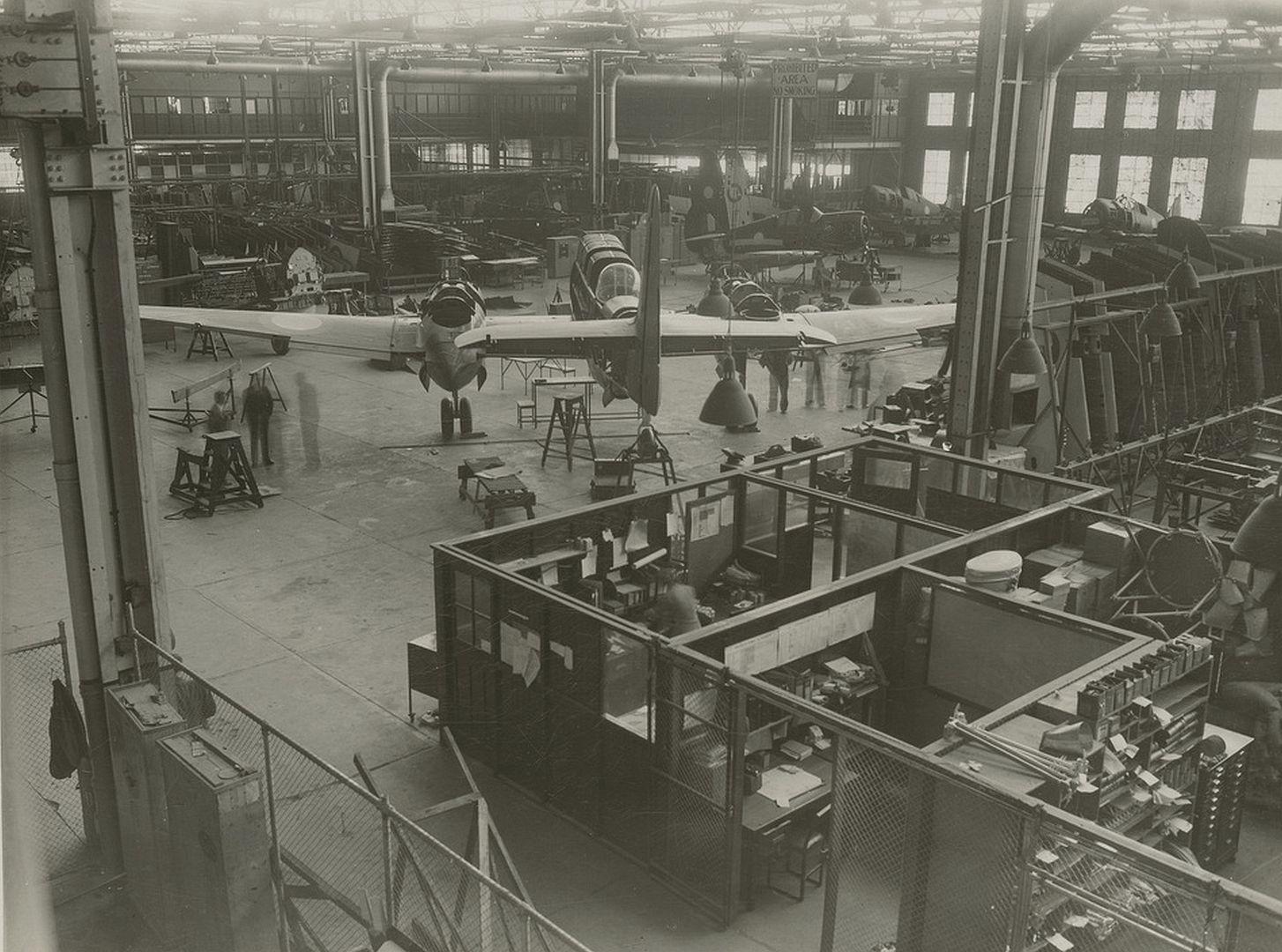

In June that year the Australian government, no doubt alarmed by the collapsing situation in Europe, allotted funding, and the CA-4, which carried the name of “The Wackett Bomber”, began full development. A mock-up was completed later that year, followed by the building of the prototype which first took to the air on 19th September 1941 – an impressively fast achievement.
Construction

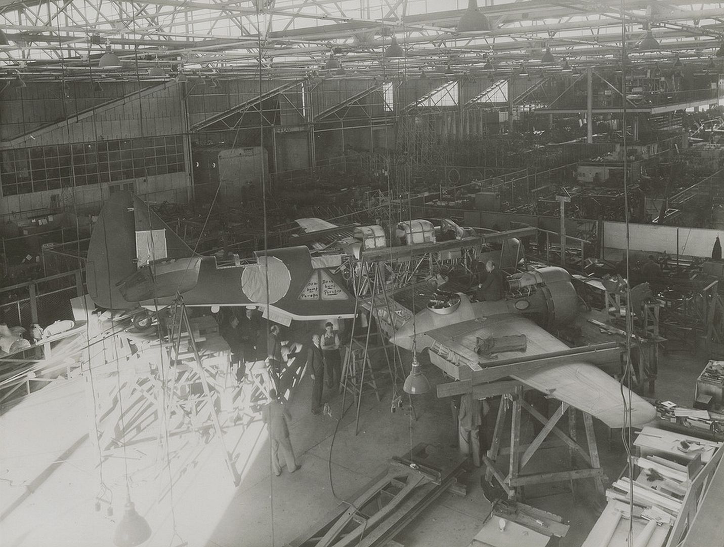

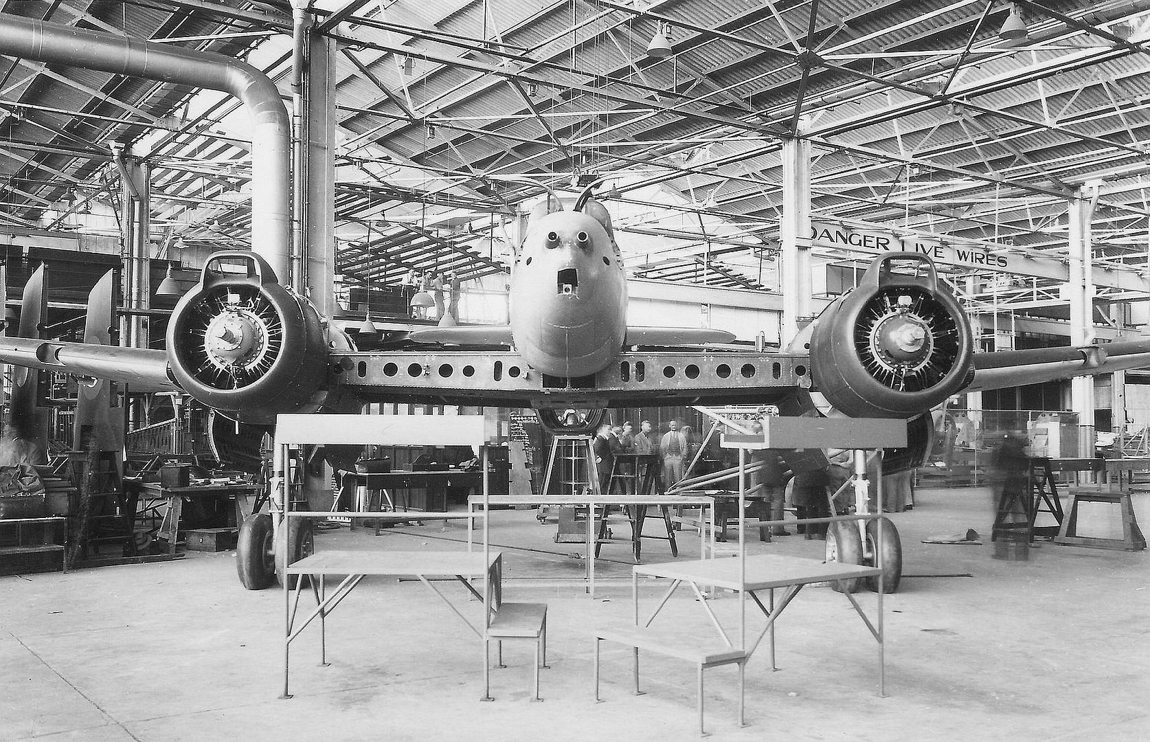

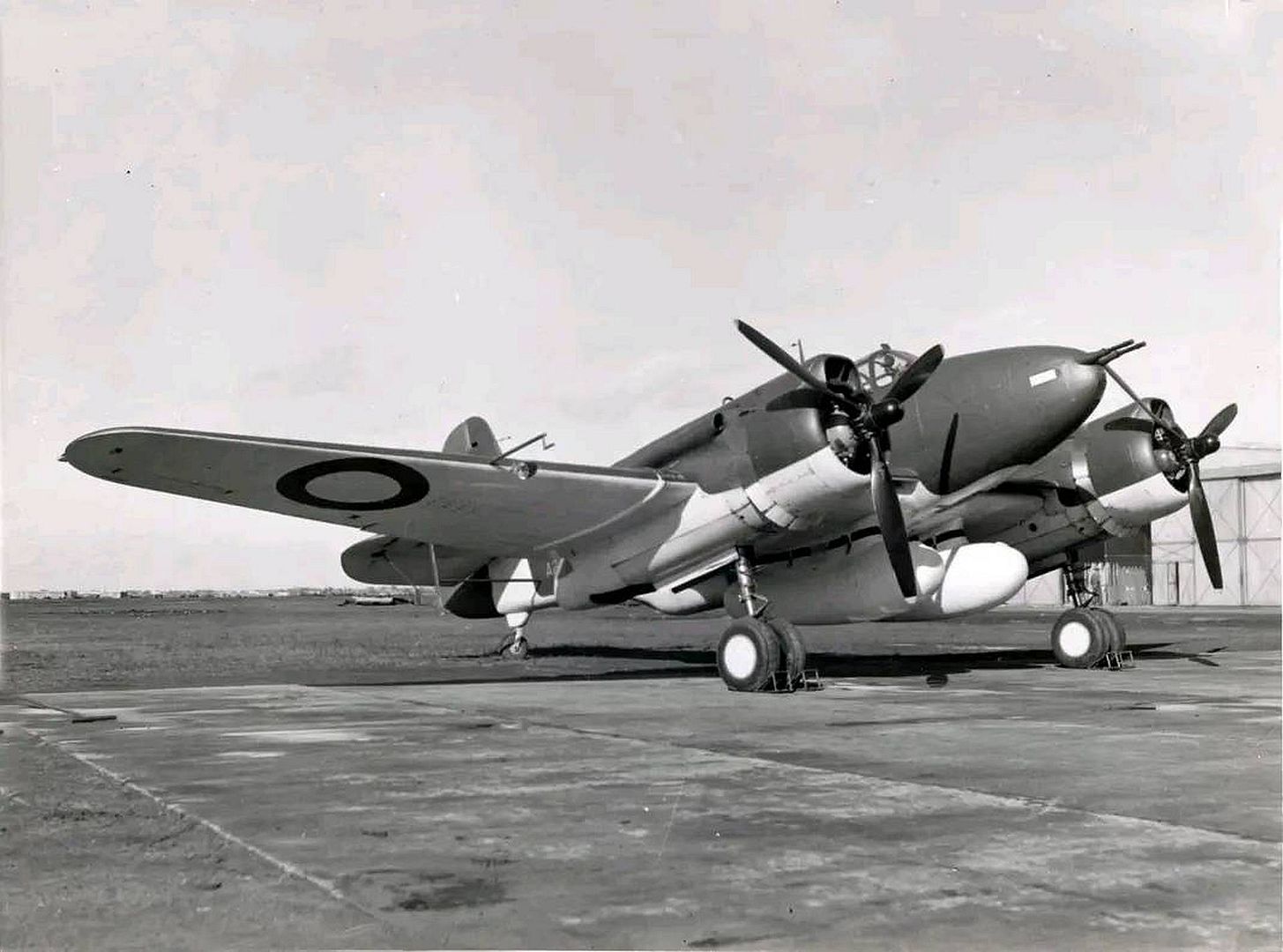

The aircraft used a mixed construction that borrowed design elements from the company’s previous Wirraway aircraft. Like that, the fuselage was composed of a welded steel tube frame with a fabric covered plywood skin.

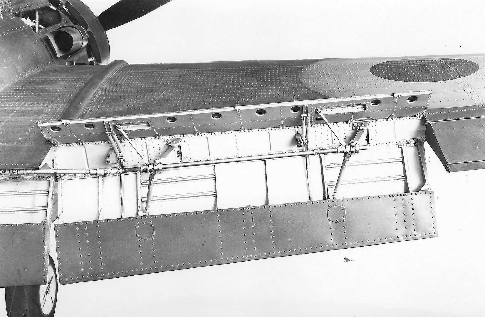

The nose and cockpit were metal skinned, while the low-mounted wing was of stressed skin construction and, in a first for the new Australian aero industry, had the fuel tanks as an integral part of the centre section wing construction.

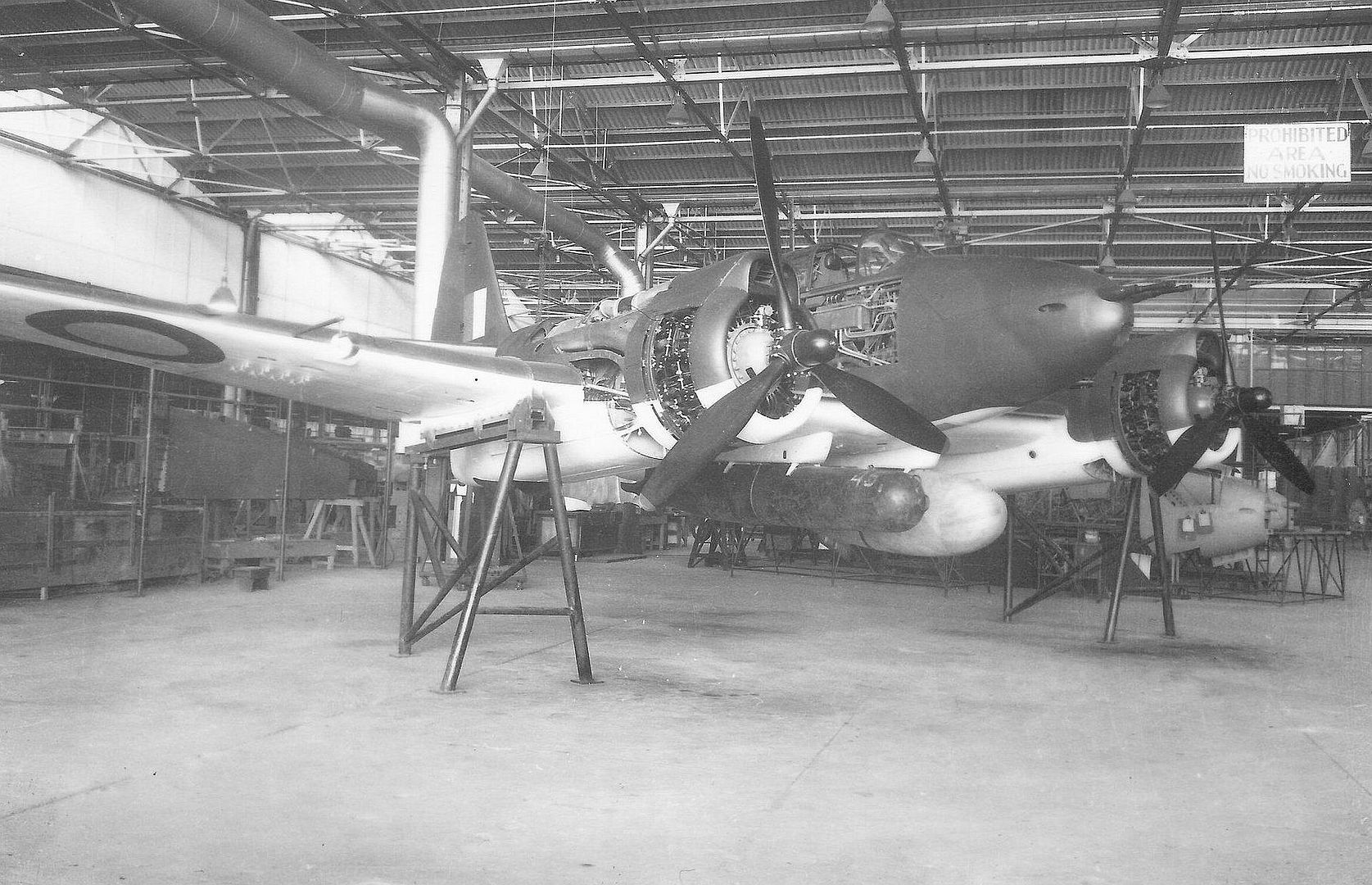

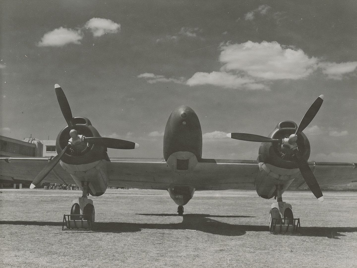

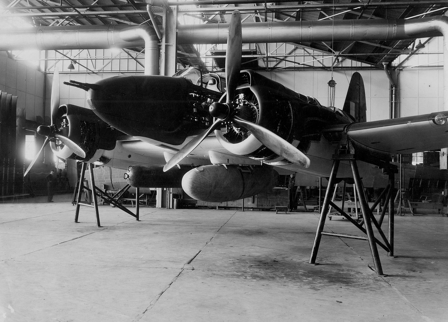

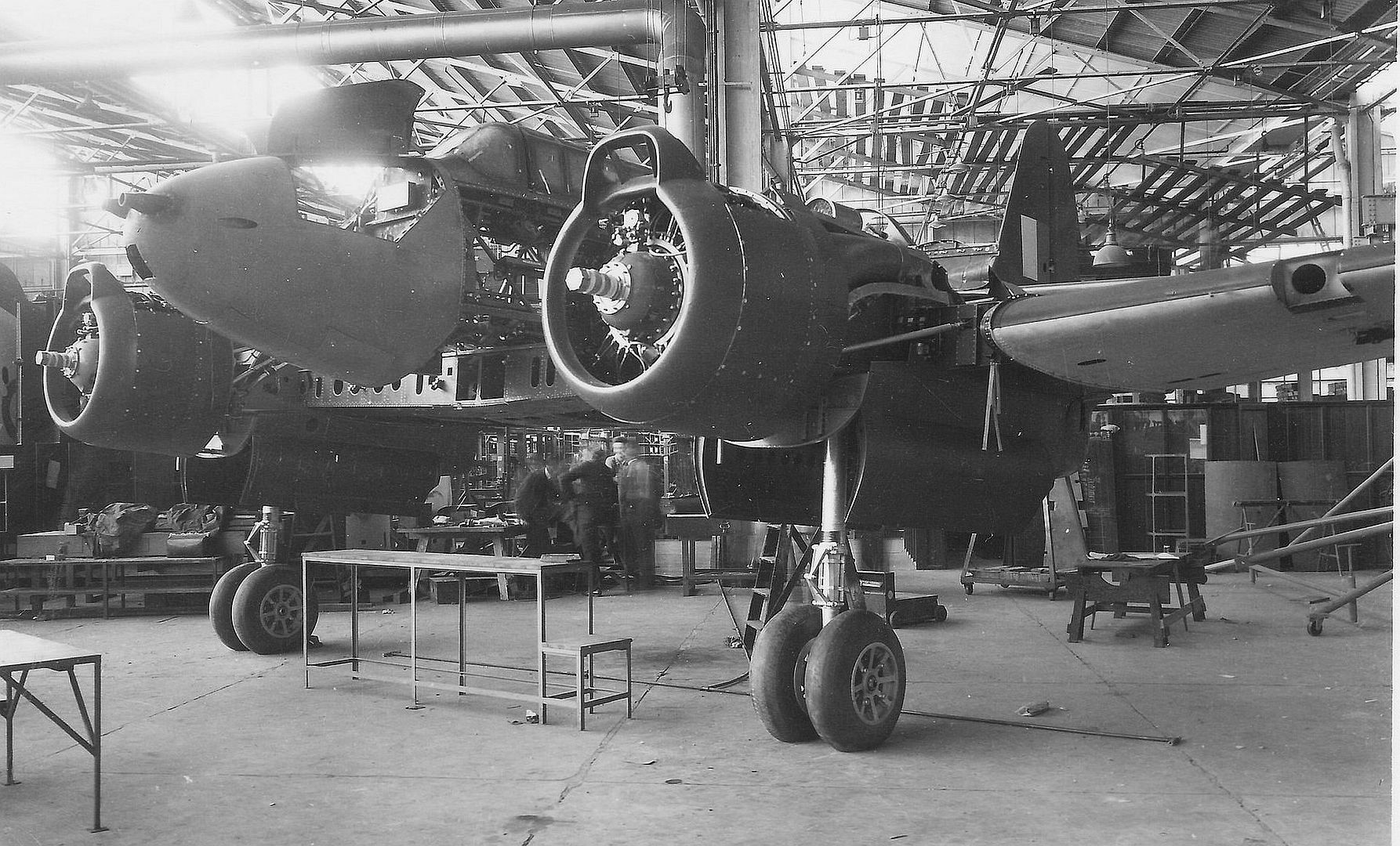

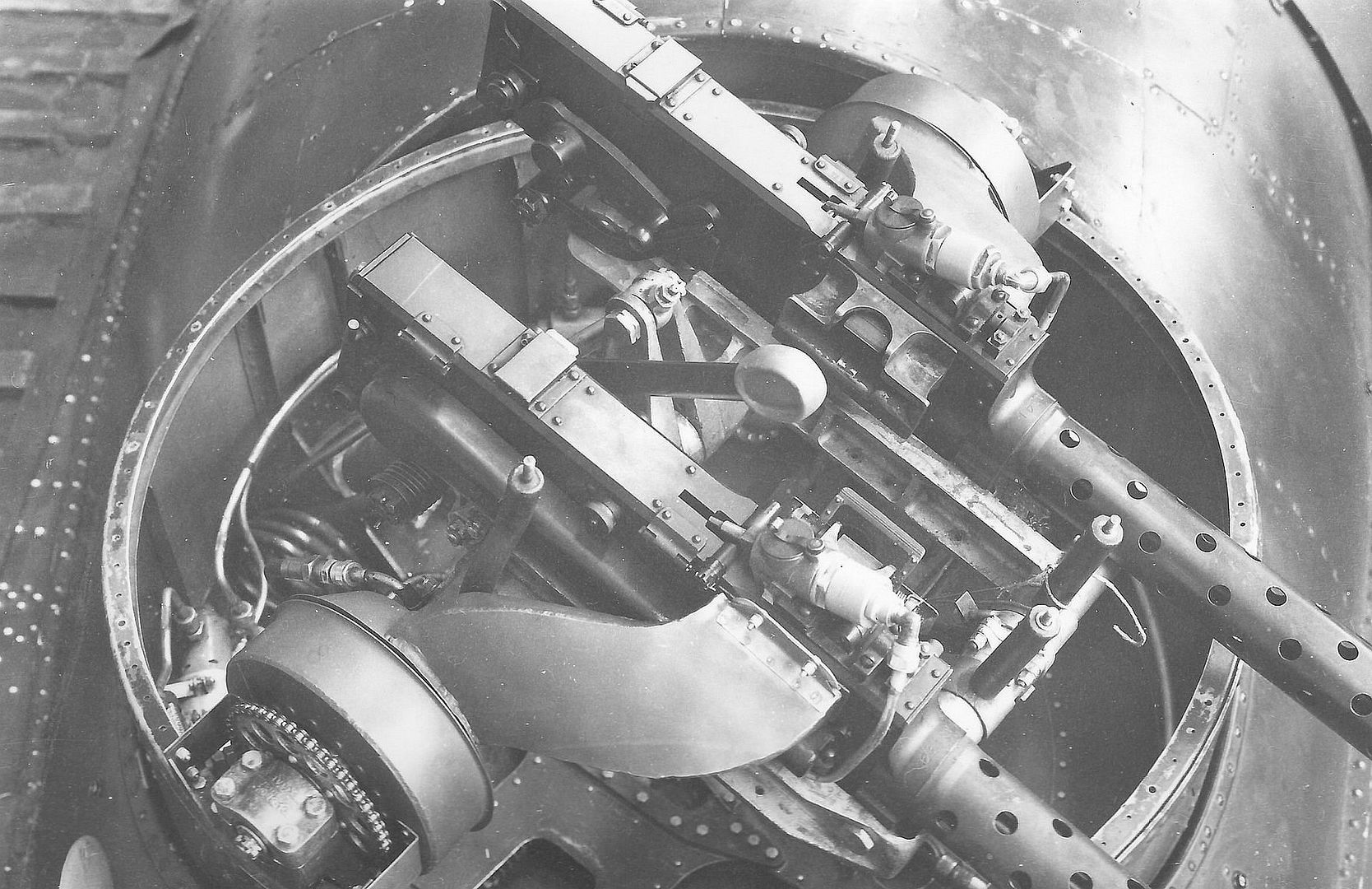

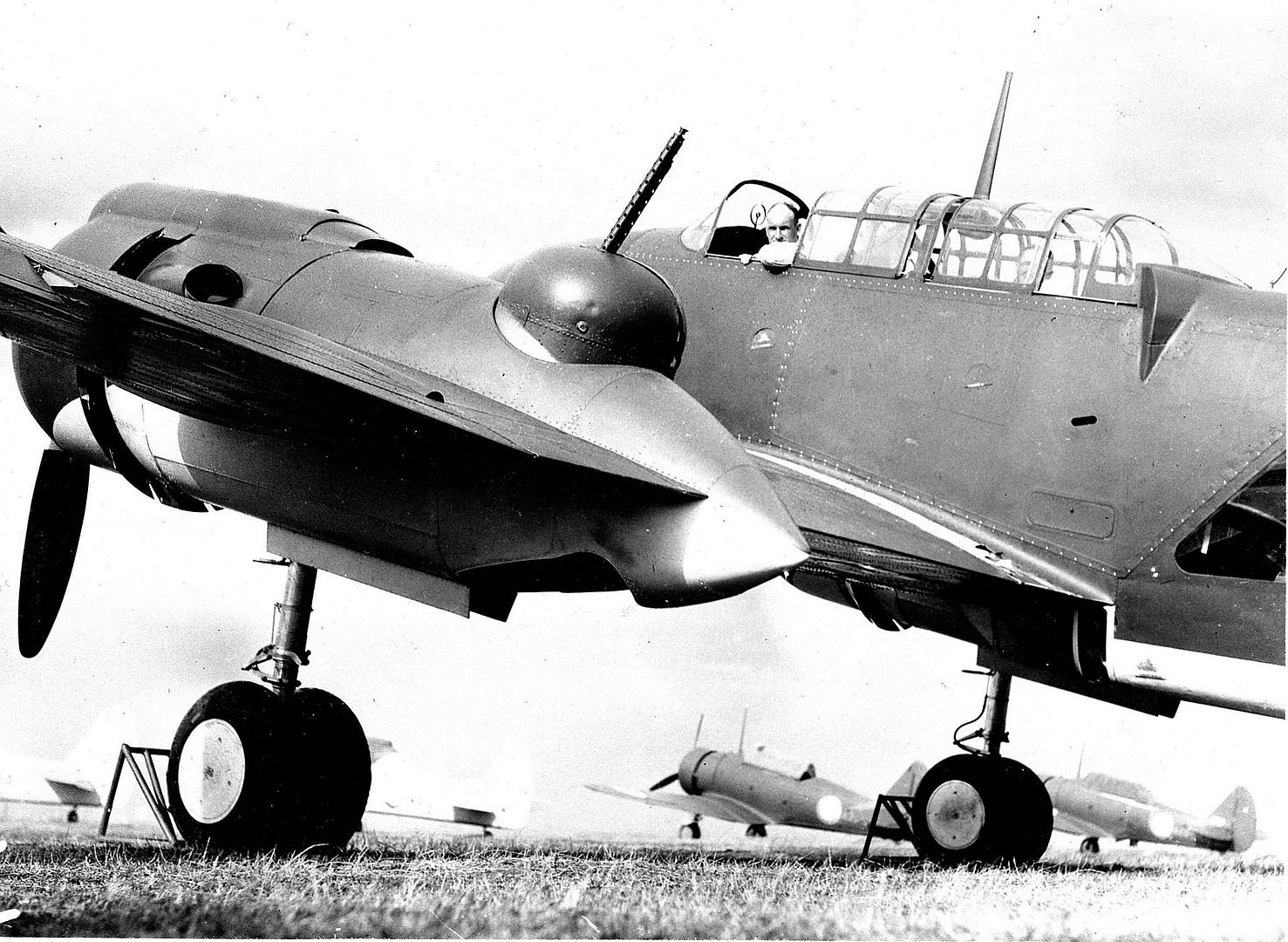

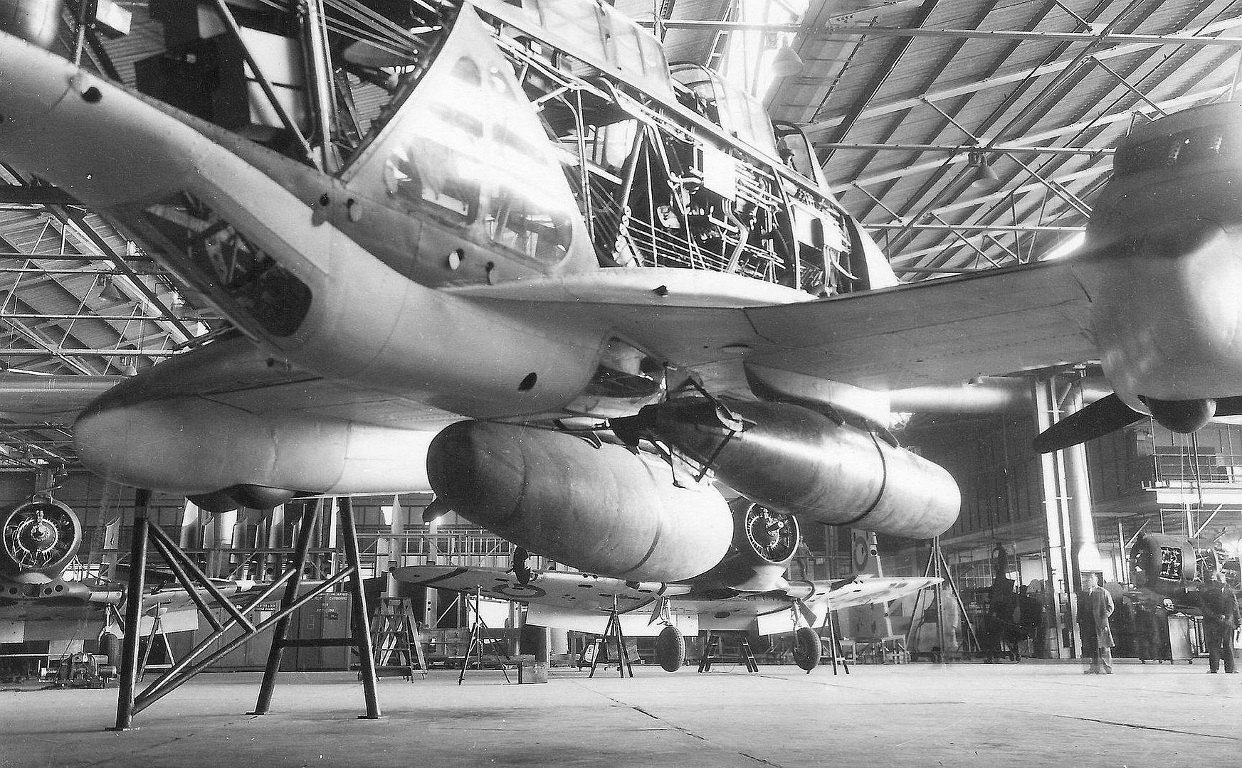

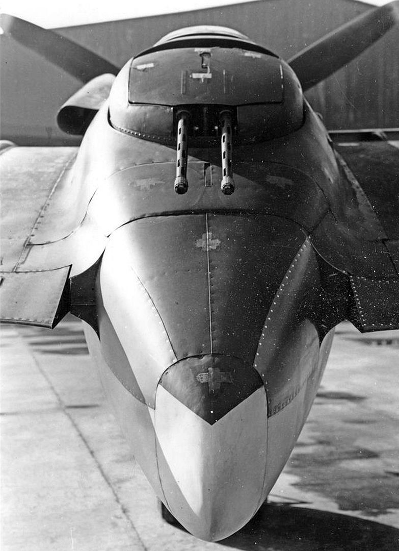

Powerplant was made up of two Pratt & Whitney Twin Wasp radials that produced 1,200 hp each, and the nacelles that housed them had some extremely interesting features. Firstly, they acted as internal bomb bays, capable of carrying a couple of 250lb bombs each. On top of that the rear of each nacelle also housed a remote-controlled barbette, both of which held twin .303 Browning machine guns.
These were controlled by the wireless operator/rear gunner who sat at the back of the long, glazed canopy.
Additional intended armament was substantial, especially by the standards of the time.
The pilot would have four .303 Browning mounted in the nose in fixed positions, while the navigator/bomb aimer, who sat in the centre of the aircraft and had two large triangular windows on either side of the fuselage to assist him in his duties, was to have a single Vickers K in a ventral position to protect the rear lower portion of the aircraft.

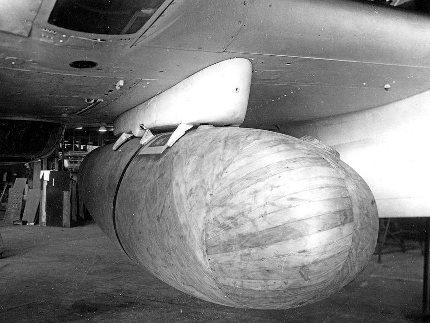

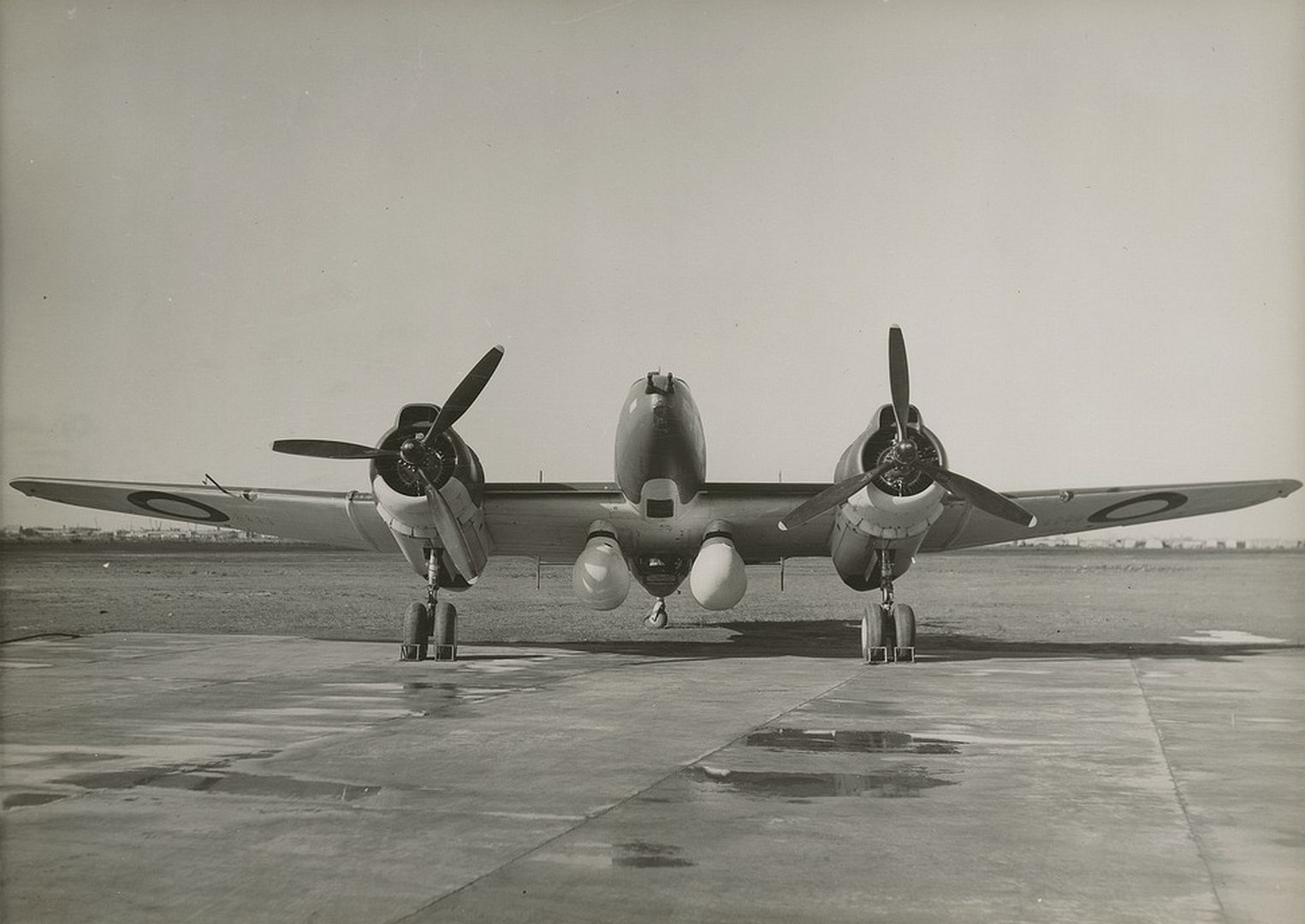

On top of the four internal bombs, the Wackett Bomber was able to carry externally up to four 500 lb bombs or two torpedoes.
These could also be replaced by two external fuel tanks, boosting the aircrafts potential range even further: an important consideration for fighting in the Pacific.

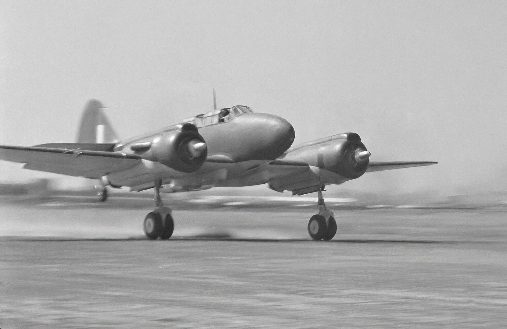

Flight trials demonstrated that the aircraft had comparable performance to contemporary aircraft, with a maximum speed of around 280mph (450 kph). But as testing proceeded problems began to be identified.
The CA-4 had problems with overheating engines, as well as a dangerous tendency for the elevator to lose effectiveness, particularly during landing or sharp manoeuvres. This would also be accompanied by vibrations in the aircraft.

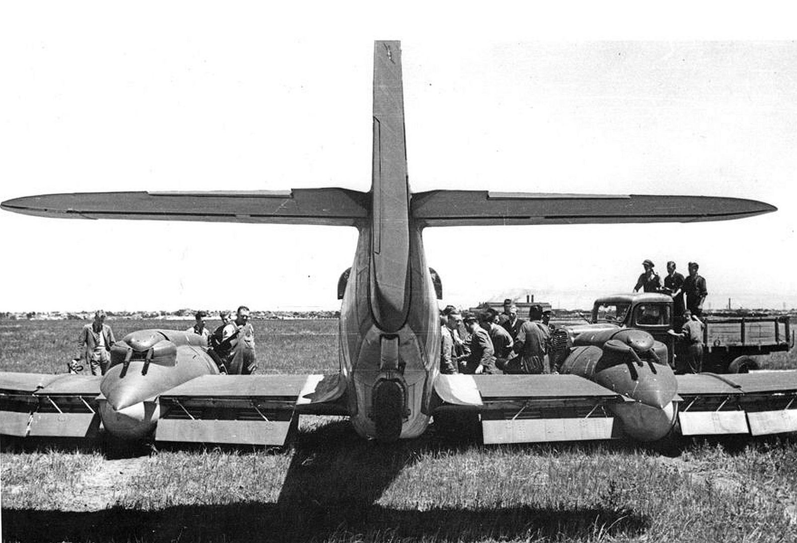

Sqn. Ldr. Cuming of 1 Aircraft Performance Unit (A.P.U) was brought in to test the CA-11 as he had flown the original CA-4. On one test flight, the pilot who flew chase in a Boomerang, noticed that the tailplane tips were vibrating through an arc of 6 inches, and that the whole of the fuselage rear of the navigator’s position was vibrating torsionally. This was obviously an aerodynamic problem, but it had not shown up in wind tunnel tests. It was finally traced to the disturbance of airflow caused by the turrets on the rear of the engine nacelles striking the underside of the tailplane. The fin and rudder were then completely redesigned and the tailplane was given 12 degrees of dihedral which rectified the problem.
The updated CA-11 aircraft differed in detail from the prototype CA-4. The canopy was extended and the gunner sat in a moulded perspex sighting turret to operate the remotely- controlled rear nacelle guns. Forward armament consisted of two 20 mm cannons and two 0.303 guns, whilst a flexible-mounted Vickers G/O gun (G/O = gas operated) was installed below the fuselage. It had a maximum speed of 435 km/h (235kt) a range of 3218 km (1,725nm) (with torpedoes); Initial climb 579 m (1,900 ft)/min; absolute ceiling, 22,000 ft (6,705
