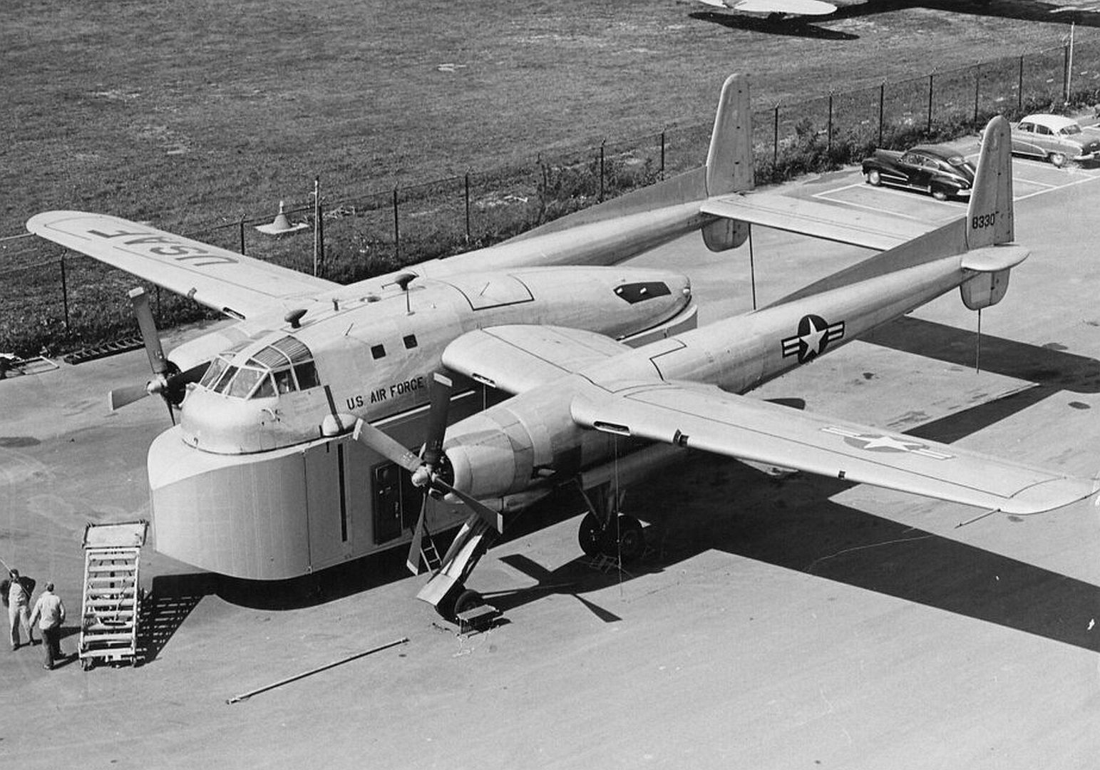

Main AdminFollowing World War II, the U.S. military faced significant logistics challenges in air cargo transport, particularly the time-consuming process of loading and unloading payloads in forward areas using existing aircraft like the C-119 Flying Boxcar, which relied on rear ramps but still required extensive ground handling that delayed resupply operations. These inefficiencies stemmed from multi-role designs that added unnecessary weight and complexity for dedicated cargo missions, prompting the U.S. Air Force (USAF) to seek innovative solutions for rapid deployment in tactical environments.In 1949, Fairchild Aircraft proposed the "Packplane" concept as a response to these issues, envisioning a modular system where cargo modules could be rapidly detached and interchanged, allowing payloads to be transported by air without unpacking and then seamlessly transferred to ground vehicles for further distribution. The design, derived from the C-119 airframe, emphasized pre-loading pods on the ground to minimize aircraft turnaround time, addressing the need for efficient resupply in combat zones where exposure to enemy fire was a risk.The USAF awarded Fairchild a contract in 1949 to develop the XC-120 Packplane prototype, with a focus on modularity to support forward-area logistics and interoperability across transport modes. This initiative aligned with emerging intermodal transport trends of the era, which promoted standardized containers for efficient movement between air, rail, and truck systems.Fairchild engineers, led by innovator Armand J. Thieblot, conceptualized key features such as quadricycle landing gear for stable pod handling and a detachable fuselage pod to enable direct integration with ground transport networks, revolutionizing military logistics by treating the aircraft as a "flying tractor-trailer."

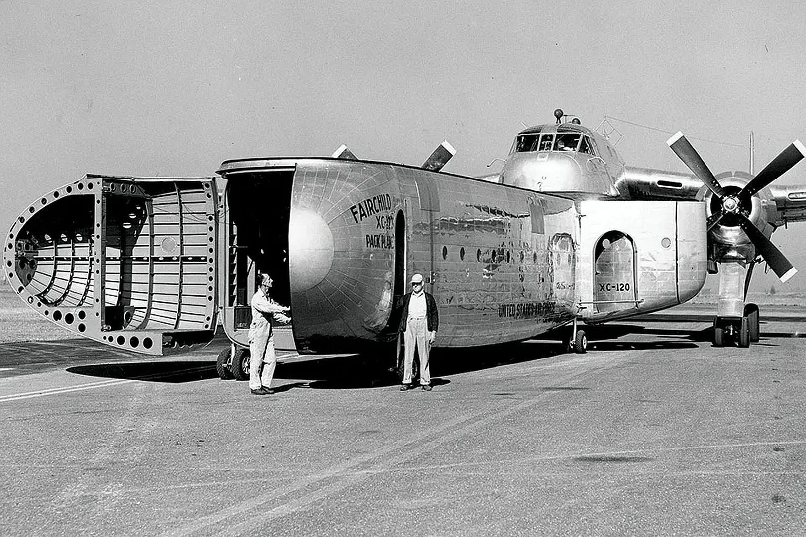

Prototype construction
The prototype of the Fairchild XC-120 Packplane was constructed at Fairchild's manufacturing facility in Hagerstown, Maryland, beginning in 1949 as an adaptation of the existing C-119 Flying Boxcar to address U.S. Air Force needs for versatile logistics transport. The aircraft utilized the fuselage of a C-119B model (serial 48-330, constructor's number 10312), from which the forward lower section was removed just below the flight deck to create space for the detachable cargo pod. The wings, Pratt & Whitney R-4360 engines, and twin-boom tail assembly were retained from the C-119 design, while the tricycle landing gear was replaced with a quadricycle configuration featuring four main struts integrated into the booms for enhanced support and adjustability when handling pods of varying sizes. Construction emphasized the integration of specialized attachment mechanisms for the pod, including electric winches for hoisting and inflatable gaskets for airtight sealing, alongside reinforcements to the elevated flight deck to compensate for the missing lower fuselage structure.These modifications presented significant engineering challenges, particularly in balancing structural integrity with aerodynamic stability in the absence of the pod, requiring extensive ground testing and iterative adjustments during assembly. The single prototype was completed by mid-1950, marking the culmination of the manufacturing process without a second example being built due to the experimental nature of the program.

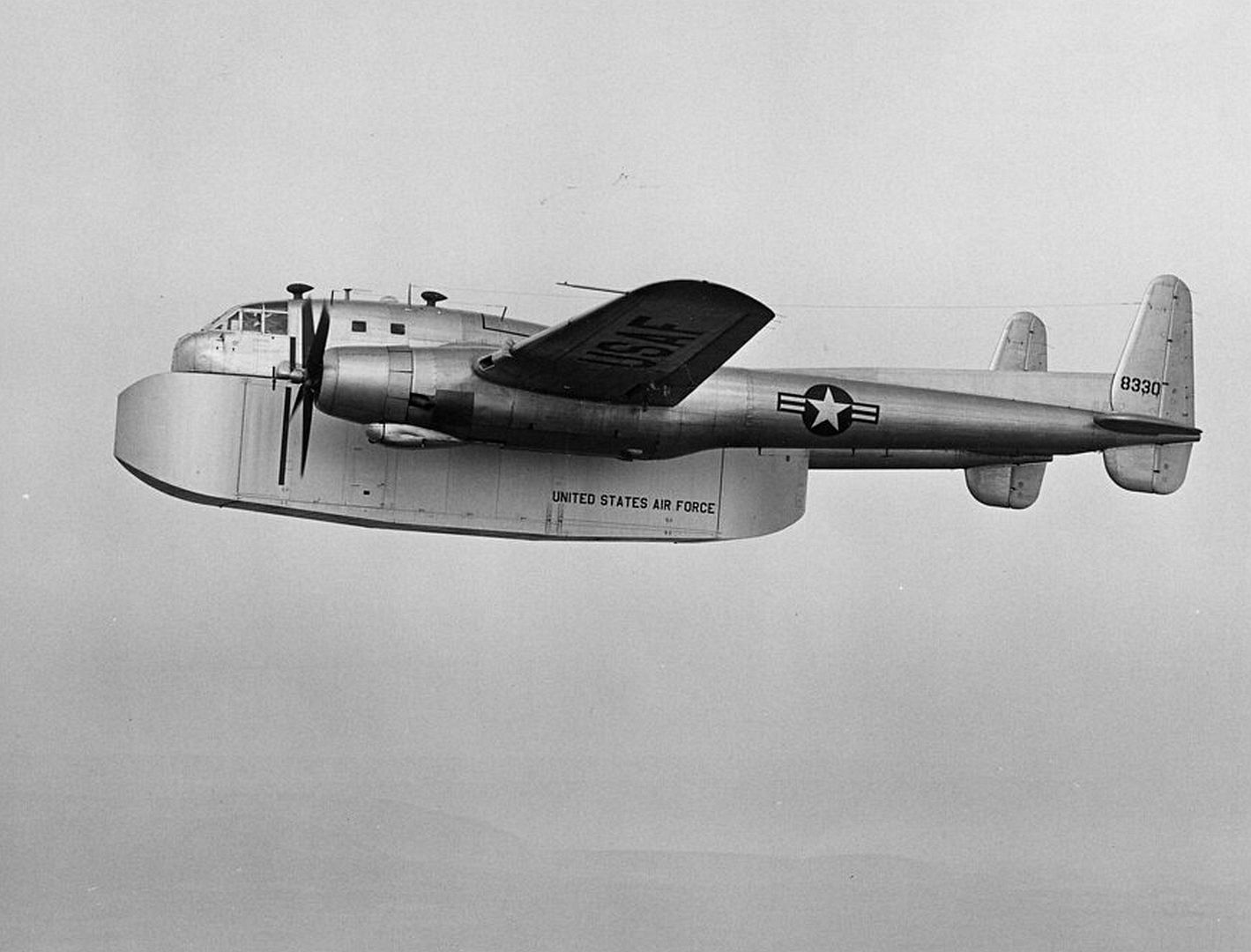

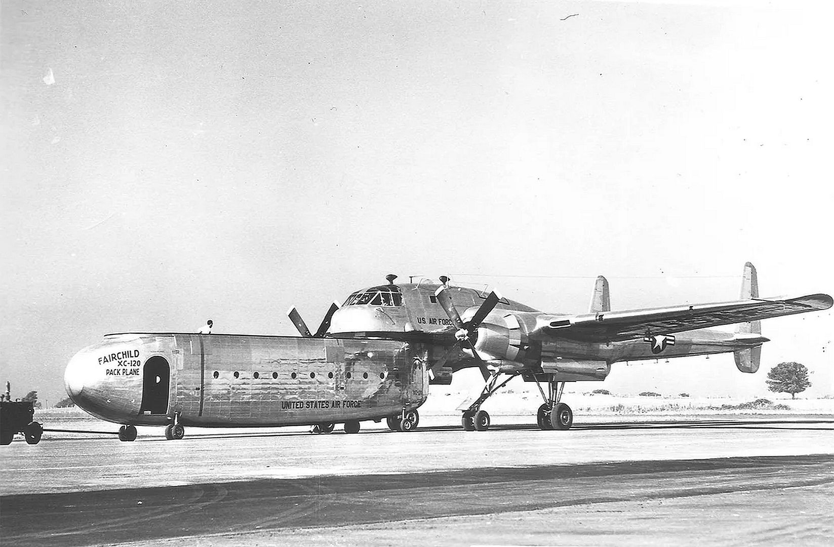

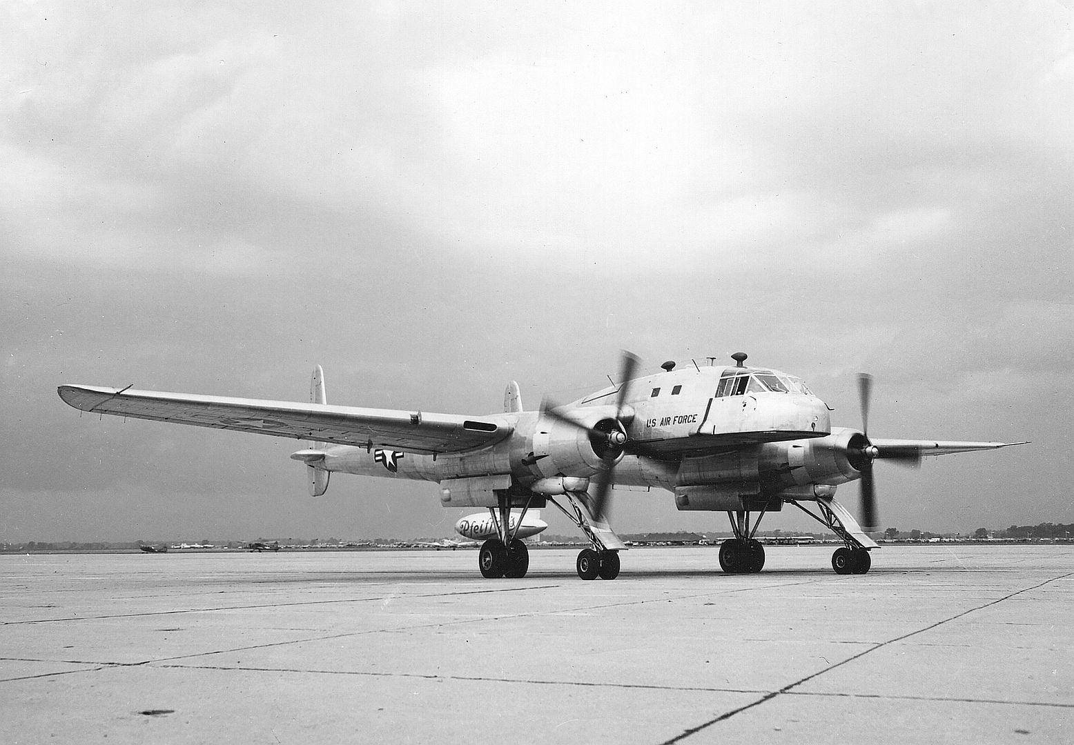

Modular cargo system

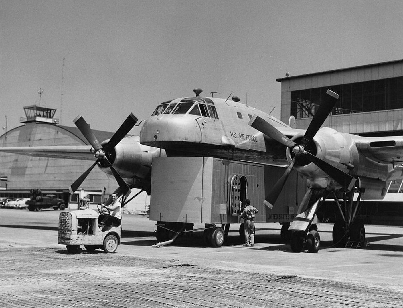

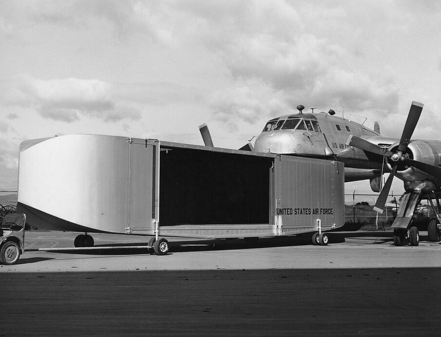

The Fairchild XC-120 Packplane featured a detachable cargo pod, known as the "pack," designed to carry up to 20,000 pounds of payload, enabling rapid modular logistics for military resupply operations. The pod measured approximately 30 feet in length with a 7-foot diameter, providing about 2,700 cubic feet of volume for cargo, troops, or specialized equipment such as litters or vehicles. The aircraft's quadricycle landing gear configuration consisted of four independent bogie assemblies mounted on extendable booms, allowing the XC-120 to straddle a grounded pod directly and lift it without requiring cranes or external handling equipment. This setup used low-pressure tires on dual-wheel units for operations on unprepared surfaces, with the pod itself supported by four small wheels for ground mobility once detached. Attachment and detachment were facilitated by electric hoists and manual straps integrated into the fuselage, achieving a swap time of around 10 minutes in ground tests. This modular system offered key advantages for austere environments by minimizing aircraft turnaround times compared to conventional loading methods, as the pod could be pre-loaded and exchanged swiftly to keep the airframe in continuous operation.Post-detachment, the pod was transportable via truck, rail, or ship as an intermodal container, enhancing overall supply chain flexibility without compromising the aircraft's empty configuration for return flights.The design stemmed from a 1949 U.S. Air Force contract aimed at improving tactical resupply capabilities. Engineering features included weatherproof seals around the pod interfaces and quick-connect electrical systems to ensure secure reattachment and maintain aerodynamic integrity during flight. The pod's floor aligned seamlessly with the aircraft's rear ramp for direct loading, supporting efficient transfer of palletized or bulk cargo in forward areas.

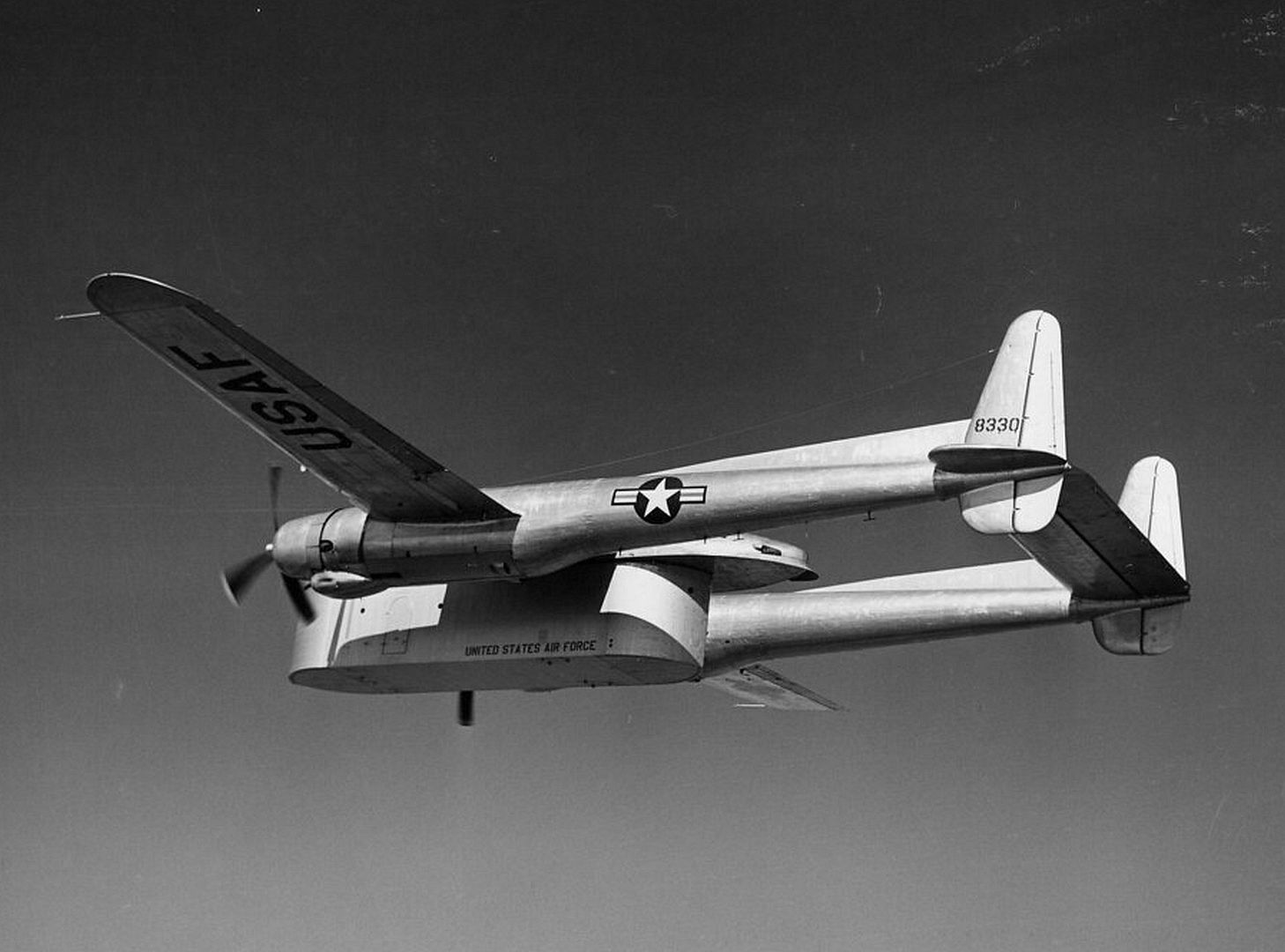

Airframe and propulsion

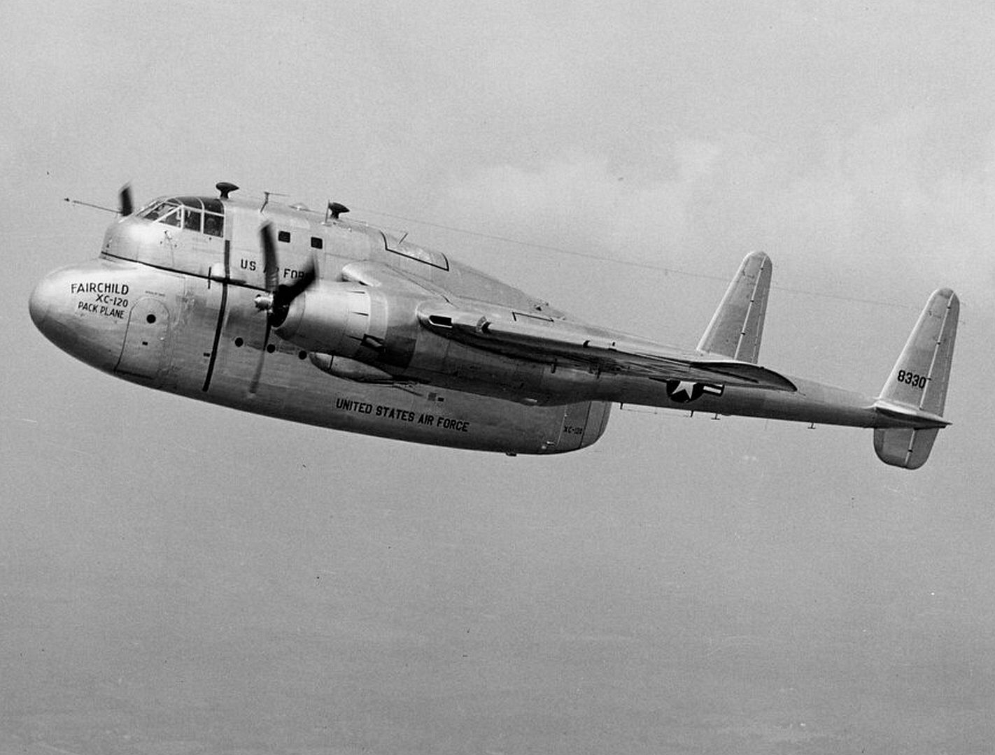

The Fairchild XC-120 Packplane featured a high-wing monoplane airframe with twin booms supporting the tail surfaces and an elevated flight deck positioned forward, derived from the Fairchild C-119 Flying Boxcar to accommodate the modular cargo concept. The structure measured 82 ft 10 in in overall length and 109 ft 3 in in wingspan, employing conventional aluminum alloy semi-monocoque construction for the fuselage, wings, and booms to balance strength and weight. Propulsion was provided by two Pratt & Whitney R-4360-20 Wasp Major 28-cylinder radial engines, each rated at 3,250 hp for takeoff and mounted in streamlined nacelles on the wing's leading edge. These air-cooled powerplants drove four-bladed Hamilton Standard constant-speed propellers with reversible pitch, facilitating short takeoffs and landings by enabling reverse thrust to shorten ground roll. Aerodynamically, the XC-120 incorporated a high-lift wing from the C-119 design, fitted with double-slotted Fowler flaps to generate increased lift at low speeds and support operations in unprepared fields. The tail assembly, consisting of twin vertical fins on the booms connected by a horizontal stabilizer, was retained from the C-119 to ensure longitudinal and directional stability, particularly during transitions with or without the attached cargo pod. The airframe integrated independent hydraulic systems for flight controls and landing gear retraction, powered by engine-driven pumps, alongside a 28-volt DC electrical system generated by engine-mounted alternators to support the flight deck instruments and lighting. Provisions were included for loadmaster oversight of pod-related interfaces via dedicated controls in the upper fuselage.

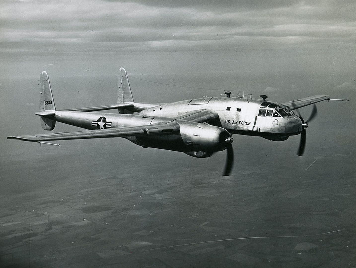

Flight testing
The Fairchild XC-120 Packplane prototype completed its maiden flight on August 11, 1950, at the company's airport in Hagerstown, Maryland. Piloted by a Fairchild test crew, the initial 45-minute hop focused on verifying basic stability and handling characteristics of the modular design. Testing progressed through extensive manufacturer-led trials in 1950, emphasizing the aircraft's performance with and without the detachable cargo pod. These efforts validated the pod-and-boom configuration's feasibility, demonstrating successful flights in both configurations via electric winches for attachment and detachment. Ground-based simulations further assessed pod integration, while in-flight evaluations confirmed handling stability when loaded. By 1951, trials shifted to U.S. Air Force facilities, primarily Eglin Air Force Base in Florida, where the Air Proving Ground Command conducted evaluations. Key tests included stall characteristics, short takeoff runs, and low-speed maneuvers, revealing a pronounced left-turning tendency during takeoff that necessitated full right rudder and asymmetric thrust until achieving 35 knots. Minor handling issues, such as insufficient lateral and directional control at low speeds, were addressed through immediate gear retraction post-liftoff to reduce drag and enhance overall performance. Notable challenges during envelope expansion involved aerodynamic instability without the pod, which introduced turbulence effects on the horizontal stabilizer and required cautious piloting. These were mitigated through procedural adjustments, allowing accumulation of substantial flight hours by 1952 and affirming the design's short-field capabilities in loaded conditions. Chase aircraft supported these phases to monitor safety and performance boundaries.

The United States Air Force conducted operational trials of the Fairchild XC-120 Packplane primarily at Eglin Air Force Base, Florida, beginning in 1951, to assess its utility for modular logistics in simulated transport missions. These evaluations focused on the aircraft's ability to support rapid reconfiguration for roles including troop transport via specialized pods, with tests demonstrating basic airworthiness for such operations as confirmed in prior flight work. Performance during exercises highlighted the pod exchange system's potential for field conditions, where pods could be maneuvered on small wheels and attached using electric winches and ball-and-socket joints, though practical swaps proved slower than anticipated due to the hoist mechanism's limitations, especially in gusty winds. The design's versatility was noted for adapting to varied environments, but no specific Arctic or desert simulations were emphasized in trial reports. User feedback from loadmasters and ground crews praised the conceptual ease of loading via the elevated deck when pods were absent, facilitating quick access for personnel or equipment. However, pilots reported higher workload from visibility constraints on the raised flight deck and inherent instability during podless flights, contributing to cautious handling requirements. One flight engineer remarked he was "glad they only made one," underscoring operational concerns.
